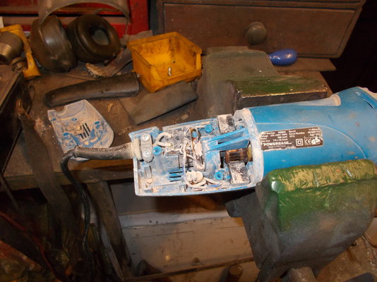

Another charity shop chuck out.
Reasons.
Damaged lead, so unable to be PAT. Good point.
No side handle, so not safe. No point
Safety guard seized. Fair point.
£5
Few minuets on my hands, between mad phone calls and escaping seeing the In laws today.
Easy enough to open, 2 screws to hold the clamp in and 2 for the cable. But what alerted me to issues was the rust on the screws holding the cable cores.
But they came out easy enough.
Now I am a bit tight, and was going to save the plug, but looking inside I decided not to.

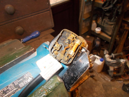

Yes, that again is rust from the cheep brass coated screws and terminals. That also is a 10a fuse.
So raid the grave yard, find a new lead, moulded plug re-wire. PAT and clean and I now have a cheep grinder.
