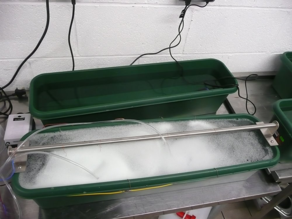

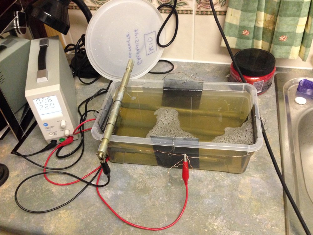

Bought a kit, still setting it up and testing but the results are both pleasing and frustratng.
