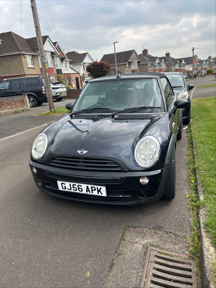

The engine is in and is running perfectly. It’s now on the road.
Cracking little car, though it still has a few niggles to sort out.

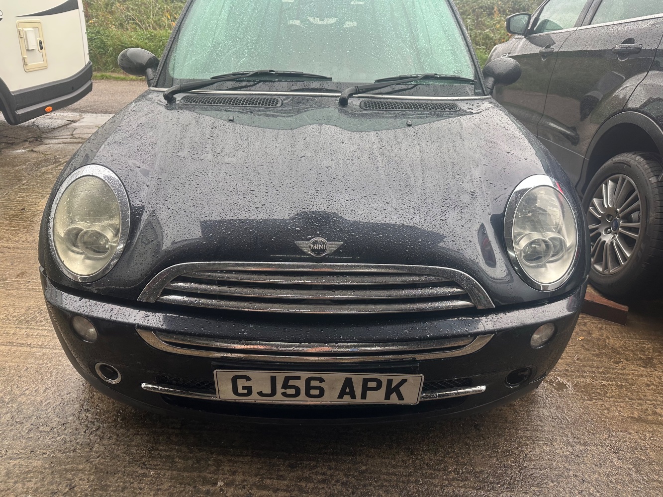

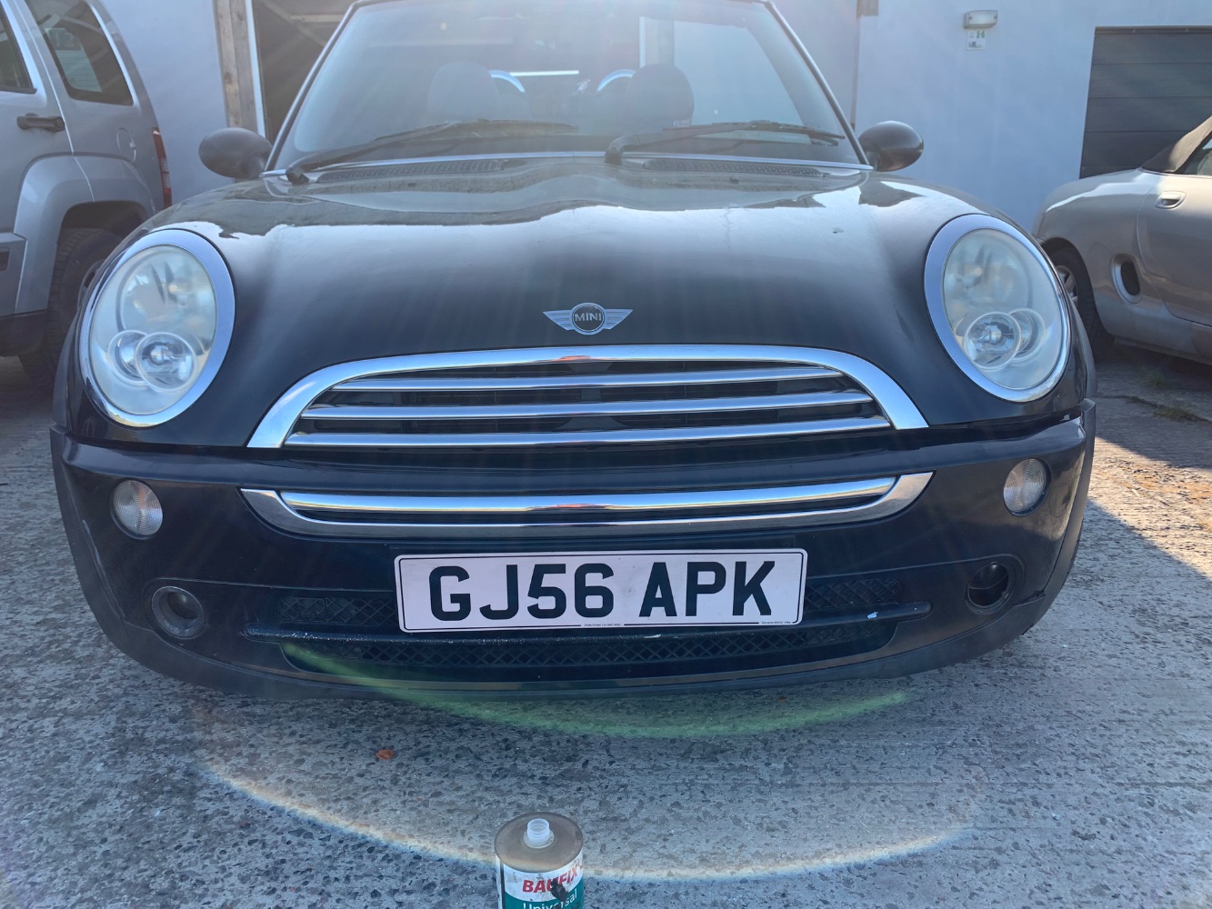

Spent some time tidying it up the other day.
The chrome had all been spray-painted black and looked awful. Fortunately no prep had been done so a quick wipe with a thinners-soaked rag took it all off and exposed undamaged trim.
View attachment 502925View attachment 502926

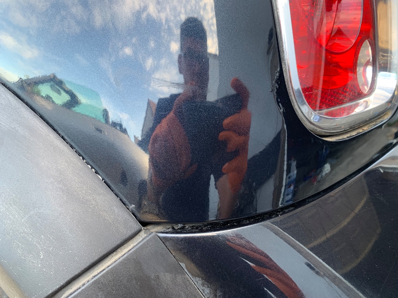

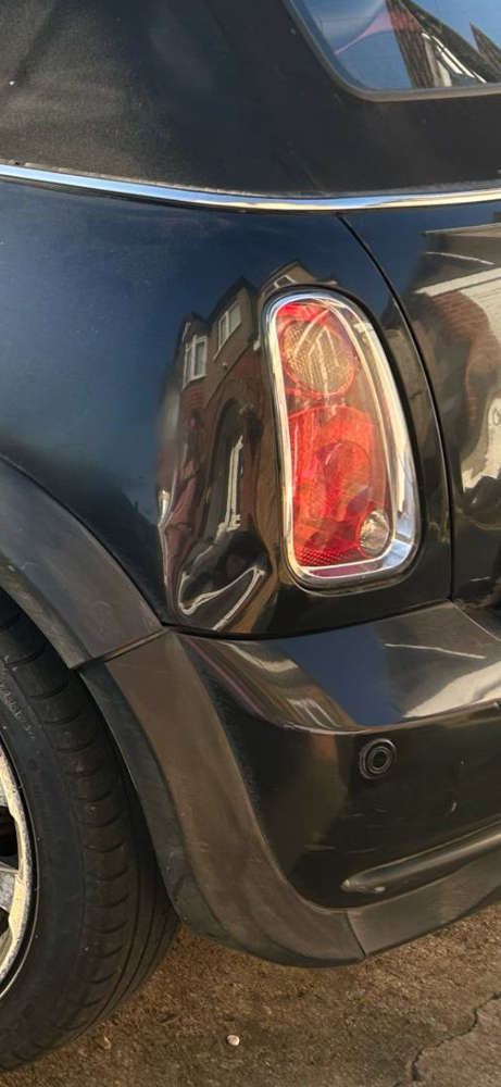

There was a nasty dent in the left rear quarter and a crease on the boot lid so I broke out the cheap Chinese hot glue dent puller kit. It actually worked way better than I thought. Not perfect but I can improve it further.
Before:
After:

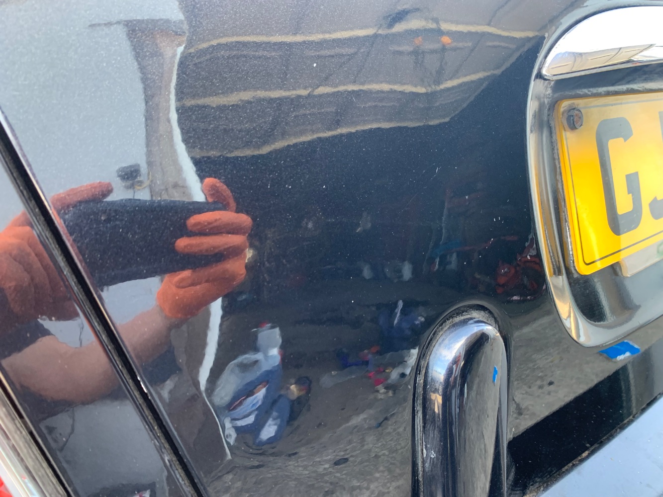

Boot lid, no before pic unfortunately.
The crease was to the left of the number plate and was quite nasty.

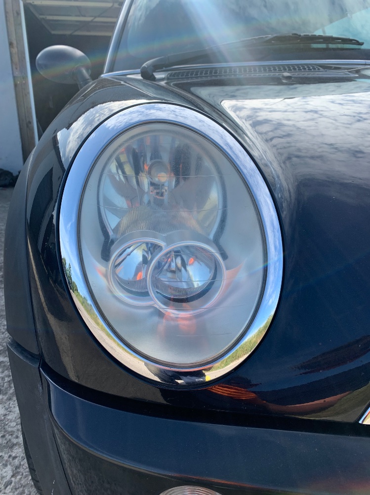

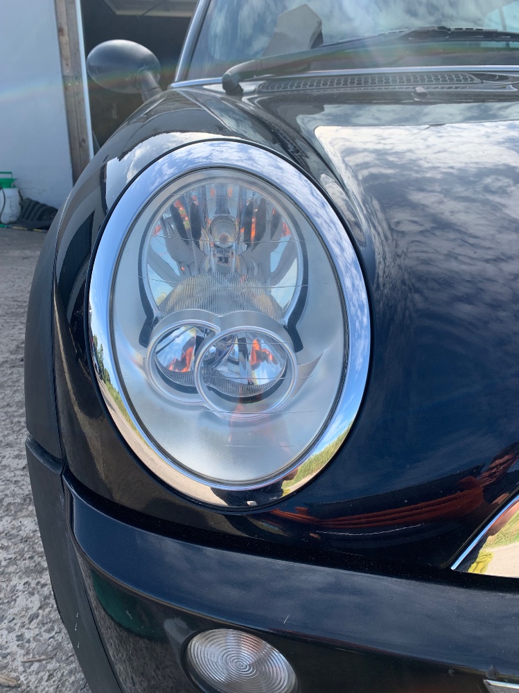

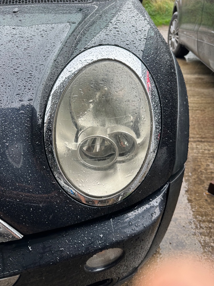

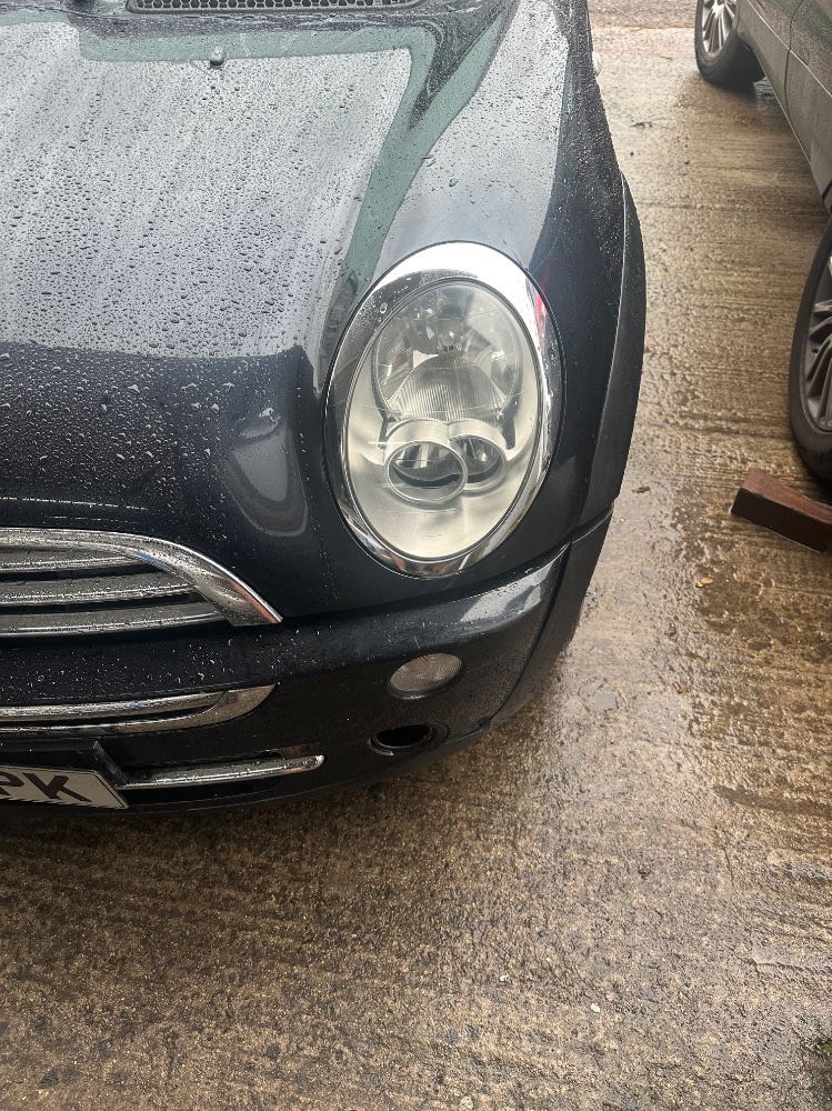

Cleaned the headlights up with some G3 scratch remover and a waffle pad. They weren’t too bad but were definitely looking yellow and dull.
Before:View attachment 502931
After:
