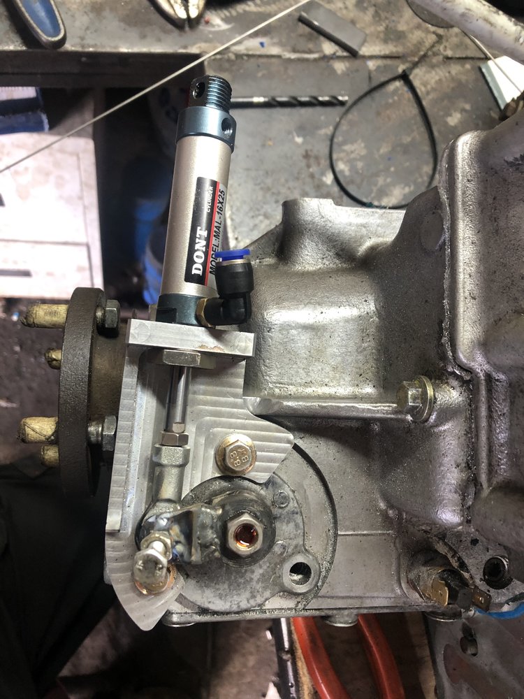

A nice air operated shifter for the diff lock. In hindsight I should have got him to bosh me out an extended arm but a bit of gorilla welding never hurt anyone
I’ve measured it so that full extension it will be held just on its detent, I’ll put a collar on the ram to prevent it retracting too farDan without some positive stops on that lever there will be a constant pressure on the hi/lo selector fork in either direction,the detents wont hold it. It will knob it in the same way a gearbox selector fork wears when someone is in the habit of resting there hand on a gearstick.
