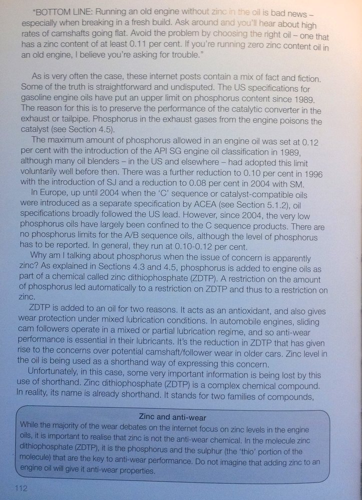

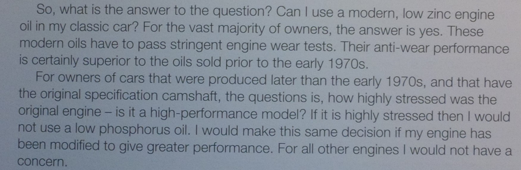

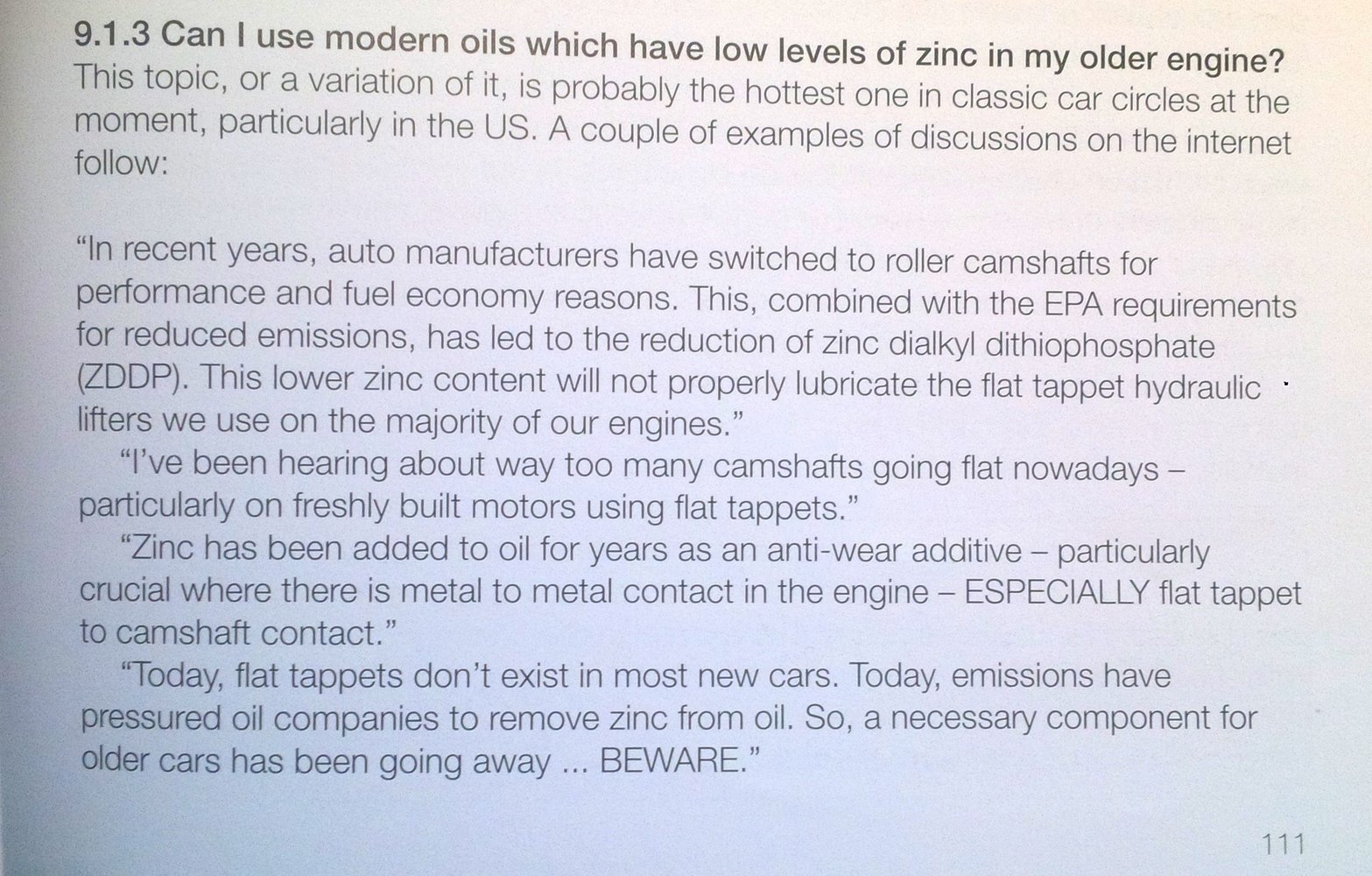

In fact, it is the first entry in the 'Answers to some common questions' chapter.
