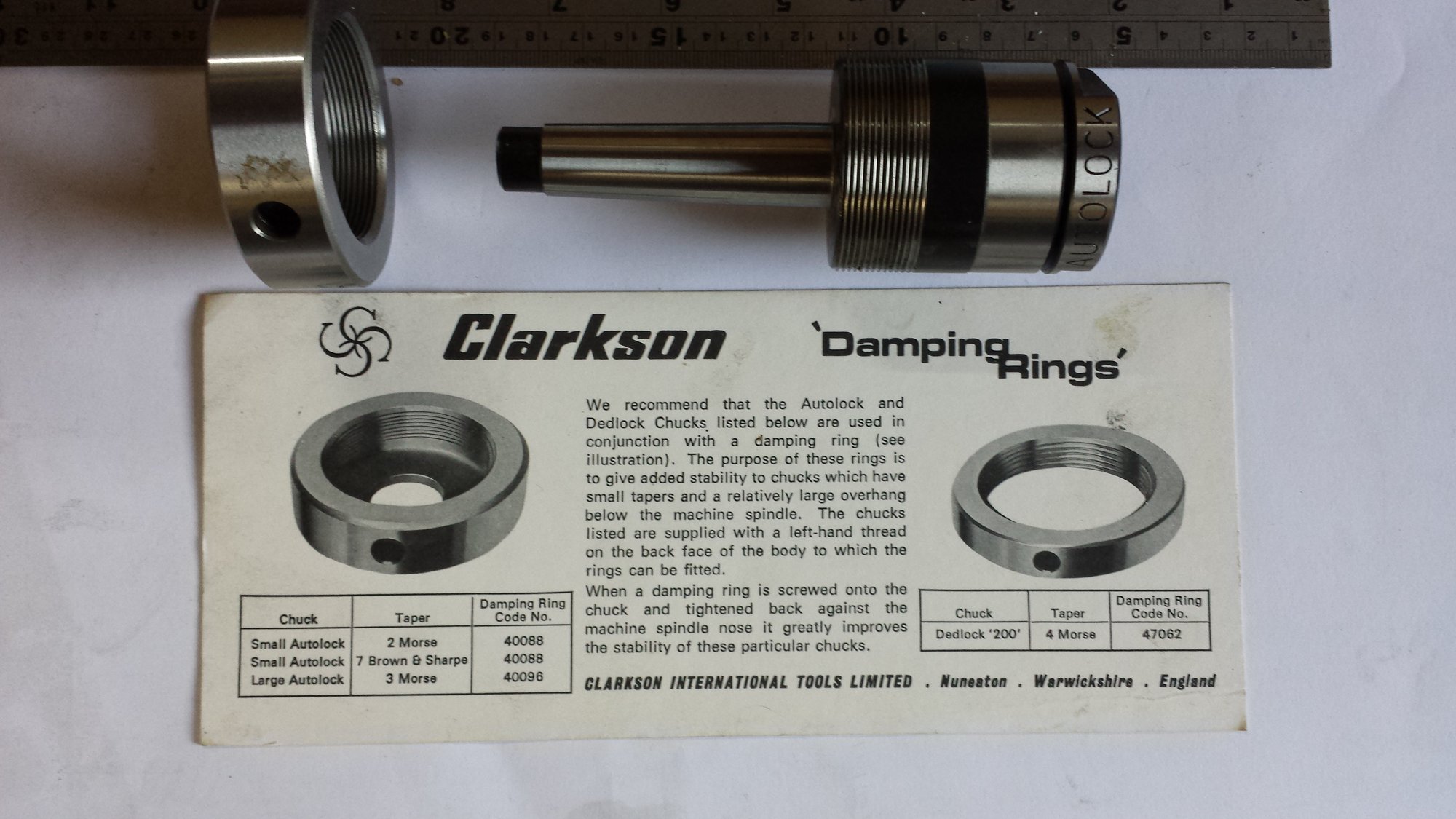

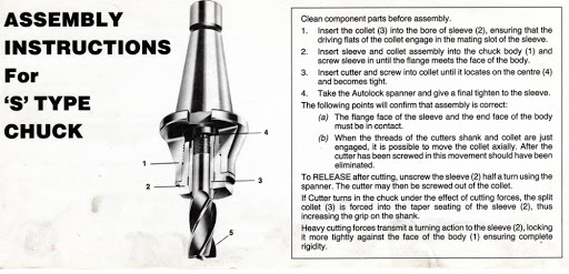

Thanks @nick952 the autolock never came with instructions, I will use that method.@Rannsachair Please re-mount your cutters in the Autolock as per these instructions:-
It does make a difference, I used to regularly burst the centres out of the 1/4" shanks, before using the above instructions (was shown the wrong method during my apprenticeship at Rolls-Royce in the late 70's)
Not mentioned in the instructions is the Screwed Ring on the top/back of the body. This should be screwed hard up against the spindle nose, using a Peg type C-Spanner after tightening the drawbar, to again help the rigidity.
