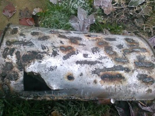

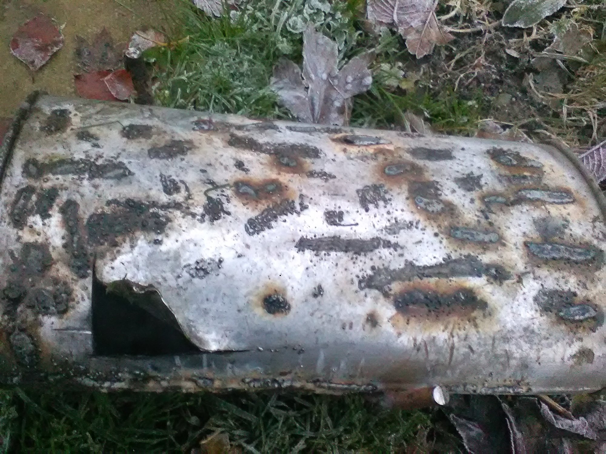

Sparky boi...erm no, just no

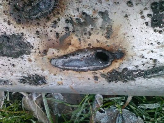

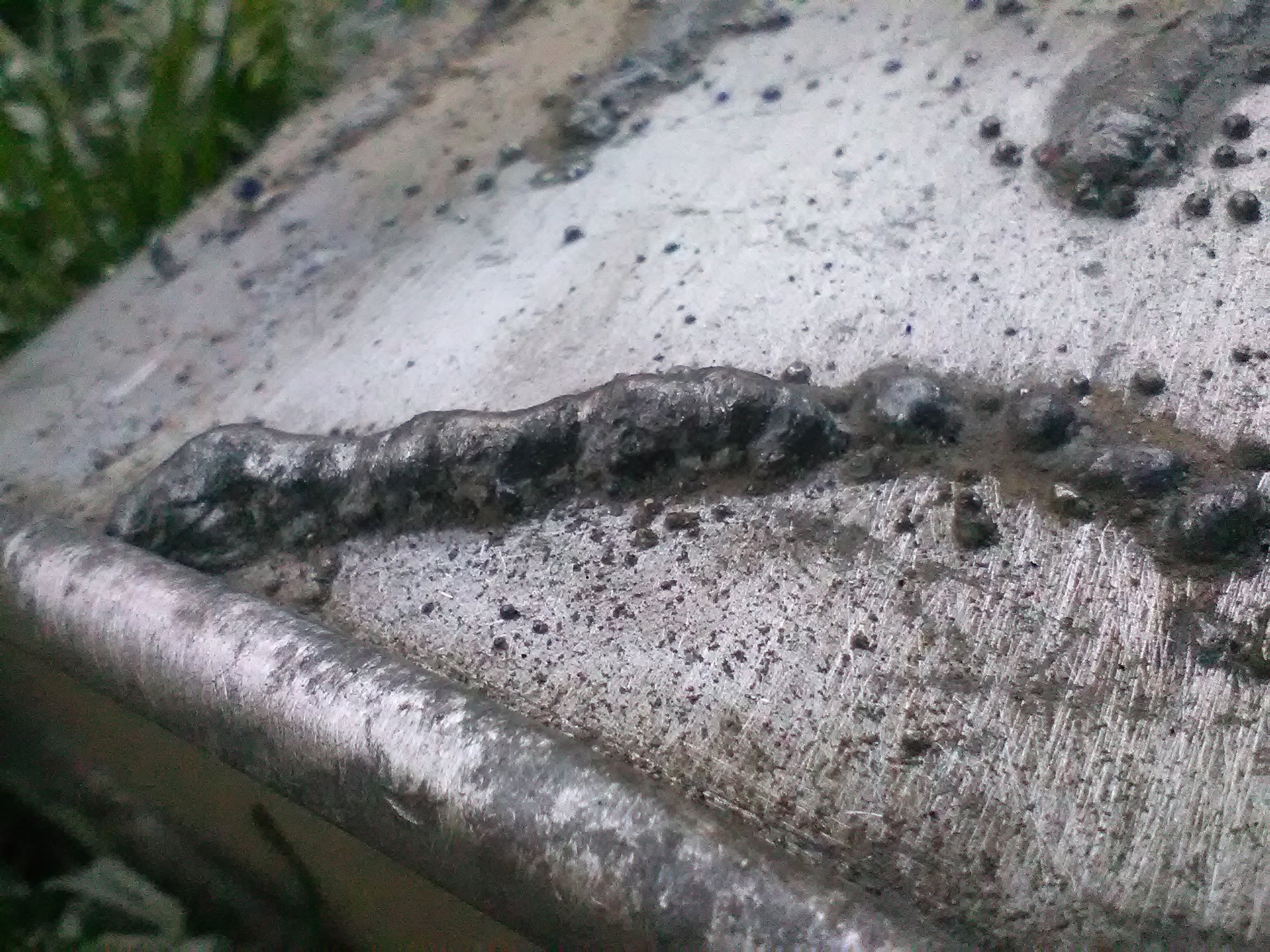

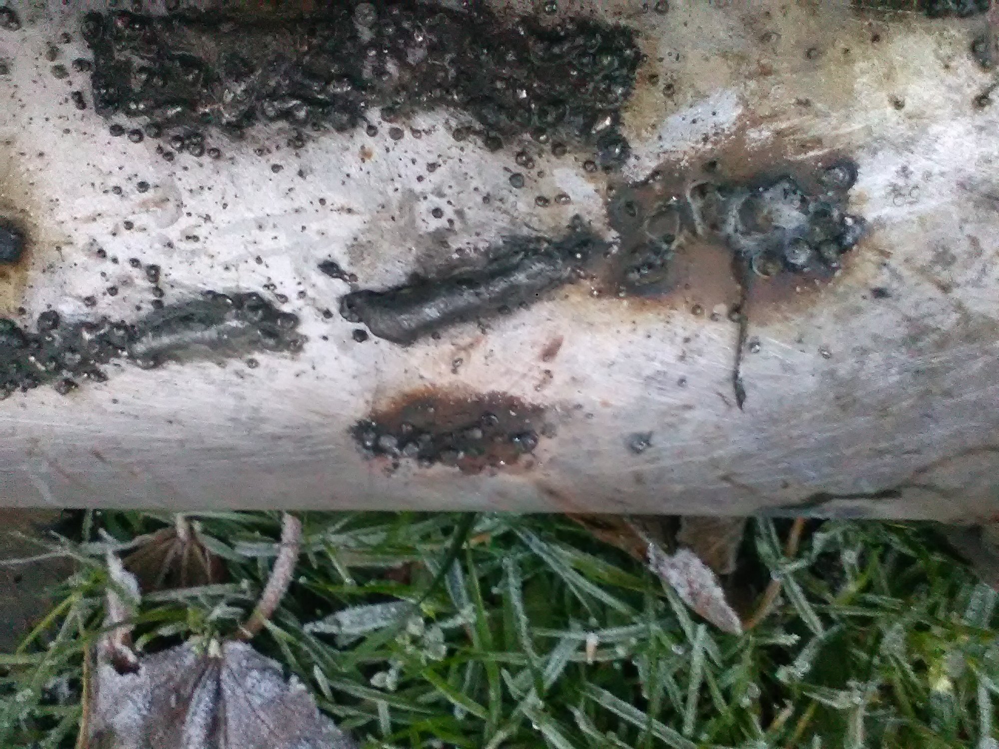

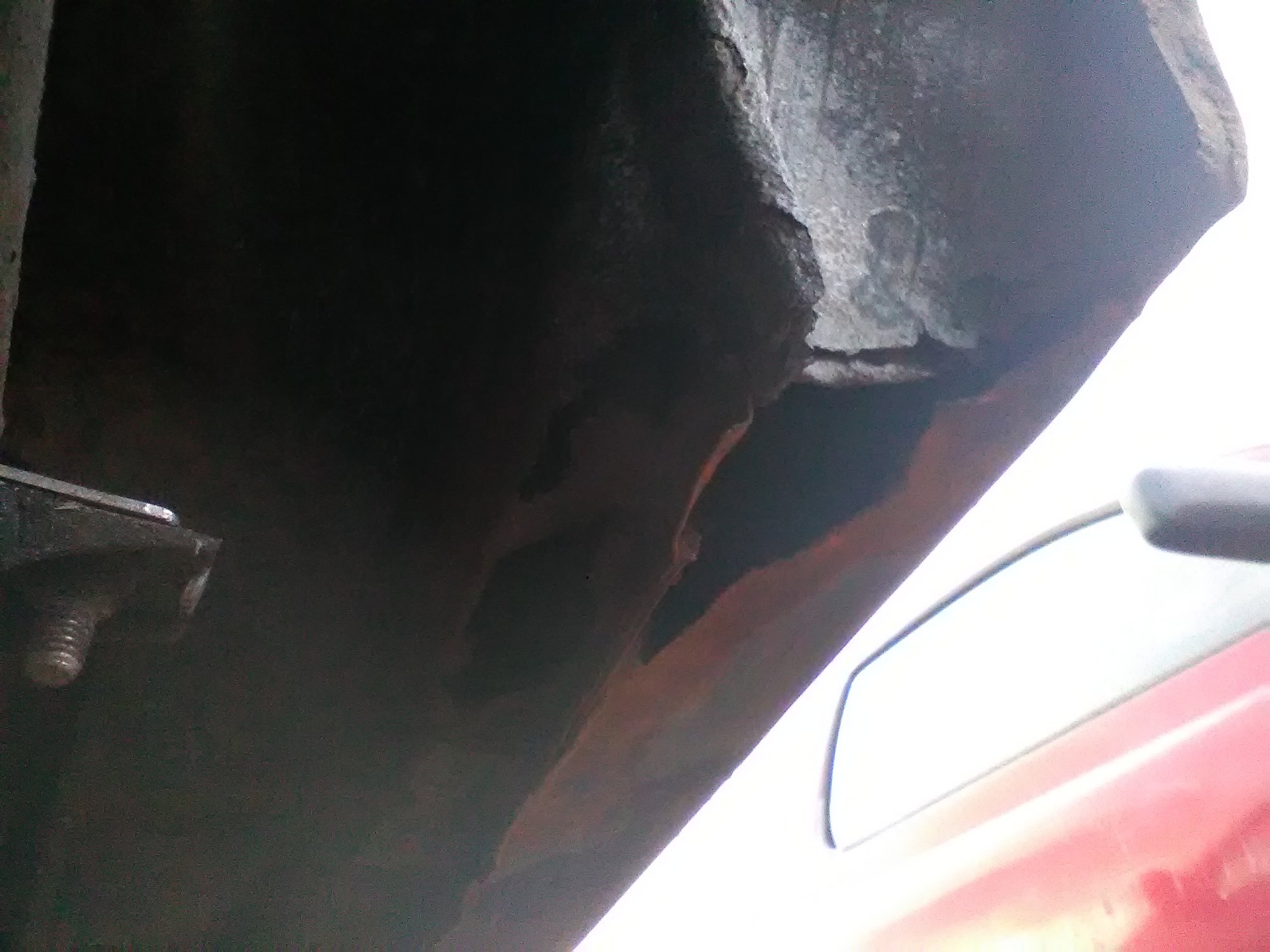

wire speed too low, gun too far from the workpiece the weld should wet in, gassless will spatter but there should be distinct areas of fusion.
when are you planning on another go i can pop over.
Yes, this is not great at all I know, but I'm learning via myself and whatever YouTube videos I can find basically :/
By wet in you mean appear through the back? or appear flatter? I'm not sure what that means.

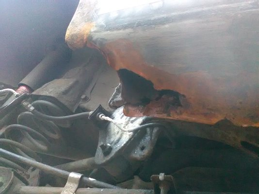

I'll be back out tomorrow daytime attempting to piece together scraps and improve. I would ideally like to have more weld and less body filler when it comes to the car, i'm not even going to attempt it yet, I got alot of practicing to do.
