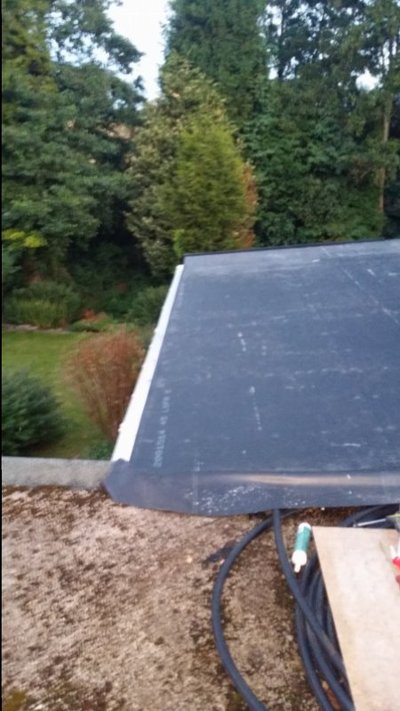

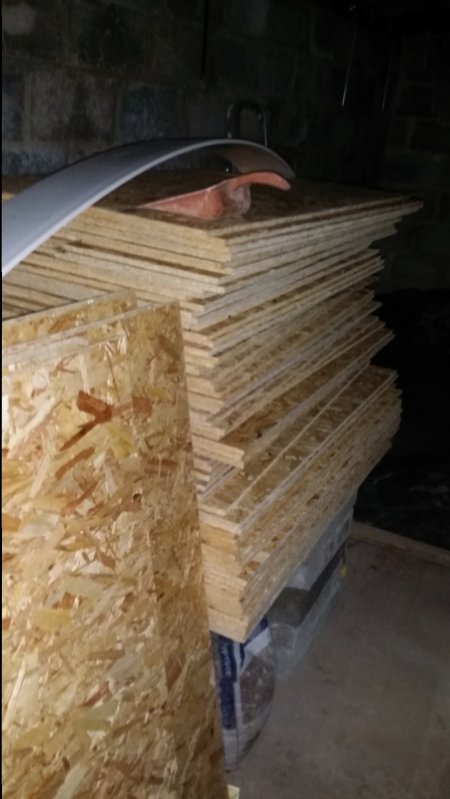

before you fit the facia board have you anything that can do below the overhang if like osb board put that on first then do the facia board
is theres any lights going in them if so get them wired up before you cover the overhang area
id rather do the overhang board first then put the facia board on after its annoying the other way around

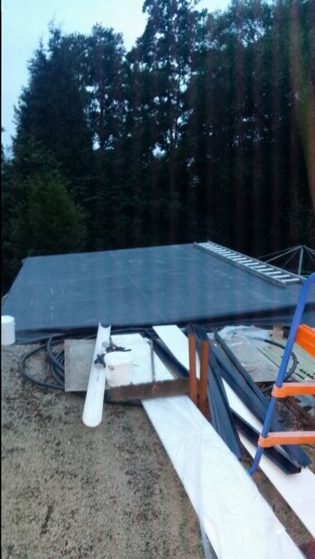

You mean like this??
