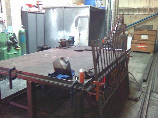

great looking table do you think a car workshop will have use for a table like thatExcuse the crappy phone picture - but here's my bench. Box section frame is set back 150mm so you can put clamps on the edge etc.
Nice! How thick's the sheet and how big is it?
Its 20mm thick steel plate. It was a 4m x 2m sheet but i got the supplier to lop a bit off so its 3m x 2m. Frame is 100 x 100 x 10 box section with 40 x 40 leg ties around the base.
Made in the day![]()
