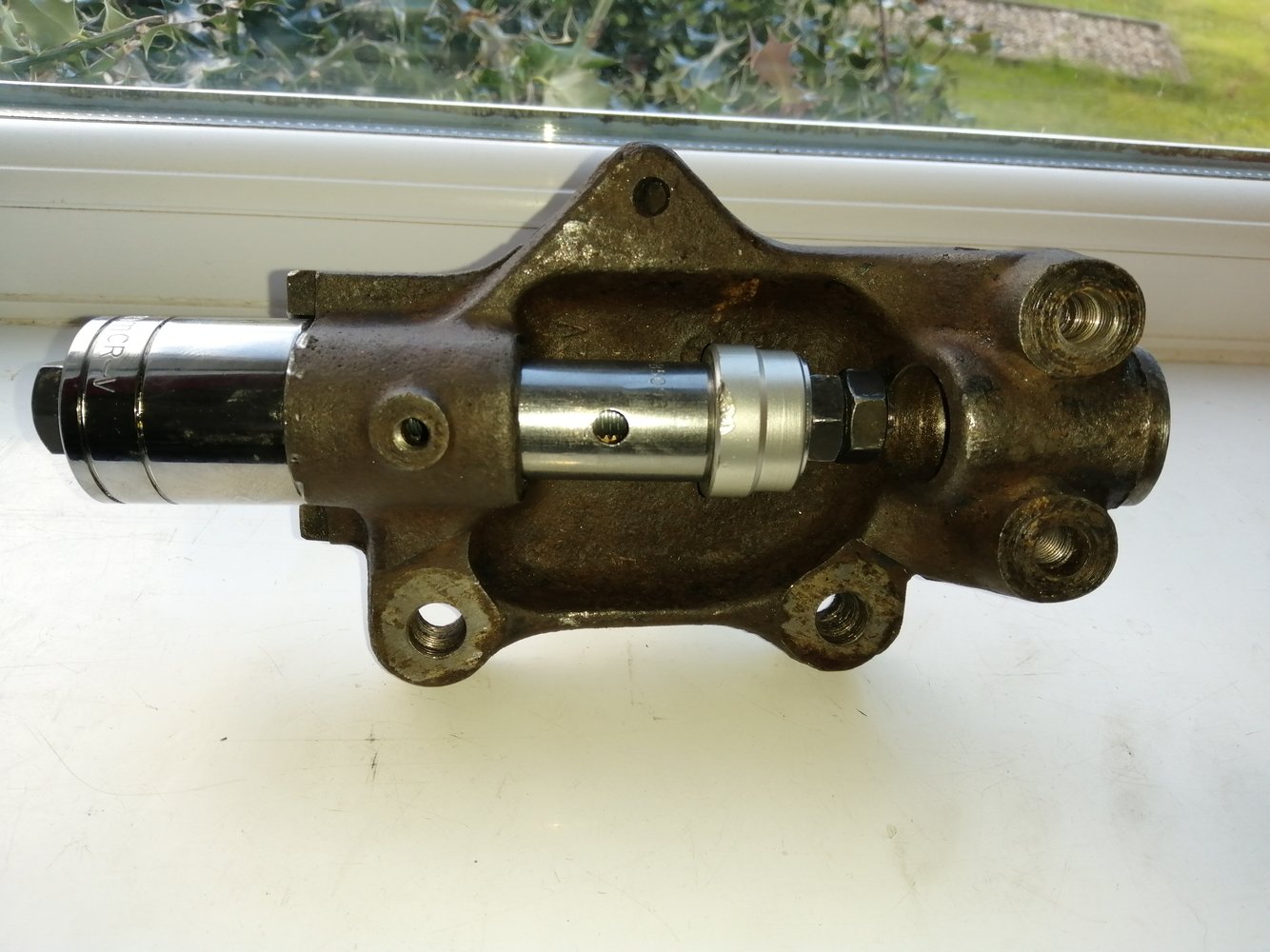

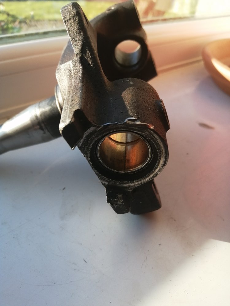

I agree, if its a pig to hold in a press just drift them in/out. Its good enough for cam bearings.Waste of time using a press to remove and refit king pin bushes ! A suitable drift the diameter of the kingpin with a shoulder slightly smaller than the OD of the bush and away you go! Probably took me longer to type this than it takes to replace the bushes? You’re going to have to ream the bushes to size . I must have done dozens of A30, A35,A40 and Spridget king pins over the years and have never used a press even when working beside one. Found the best way to sort out seized trunnion pins and bushes is to fit reconditioned lower arms from the MG Owners club or similar , leave the kingpin attached to the old lower arm its all going to be replaced anyway
Yes, I hadn't thought of the pressure on the casting. The seem incredibly tight, I'll give that method a miss.I might give that suggestion a quick go - but if the bush didn't shift immediately, I've be worried about bending the upright. In that case, I'd try support the bottom one on the tube, put a bar through the upper one to press on a spacer to push the bottom out. Then flip and repeat for the other one.

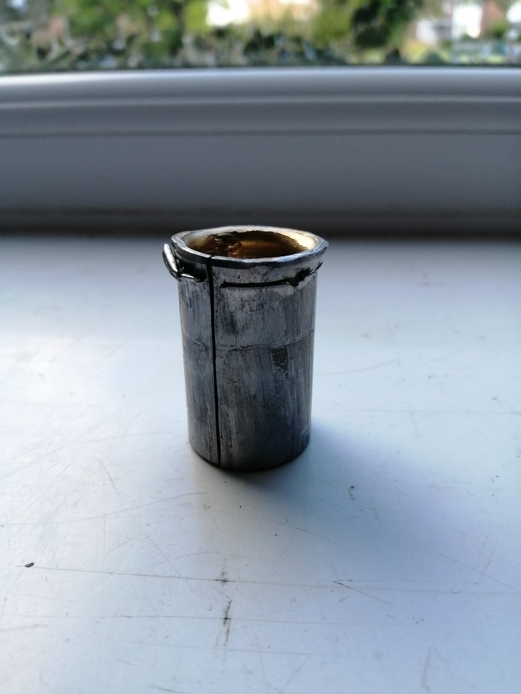

Thanks Dcal. The casting measures 23.10mm, the bushing 23.17mm (after several attempts on each with the calliper). So about .0028" bigger. There's a slit in the bushing with a slight gap to close on the steel outer layer (brass/ bronze inner has none), so I guess that should compress. Does that sound about right? I'll have a go with the setup above later today, if I get a chance.Not the same but similar.

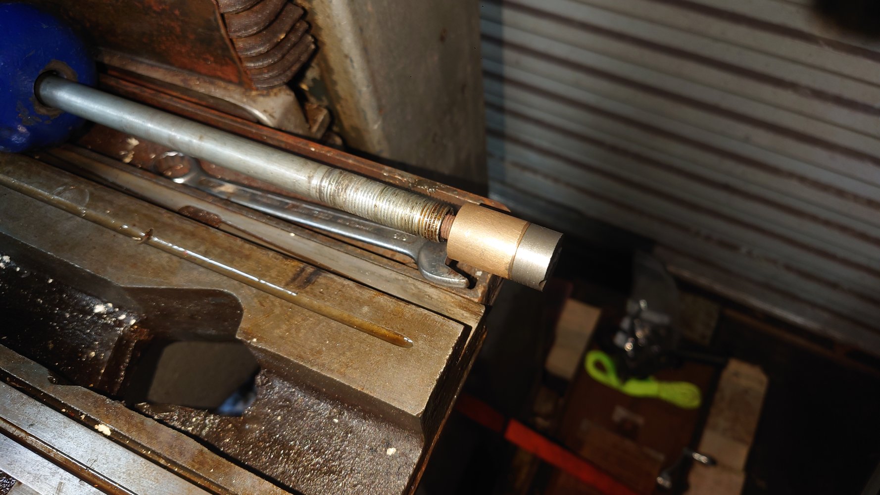

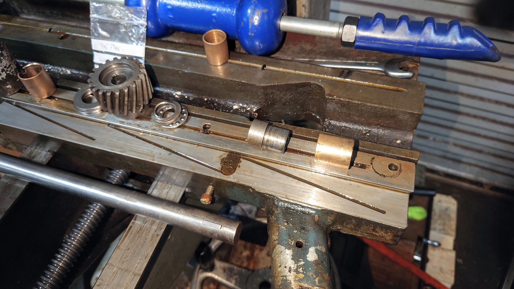

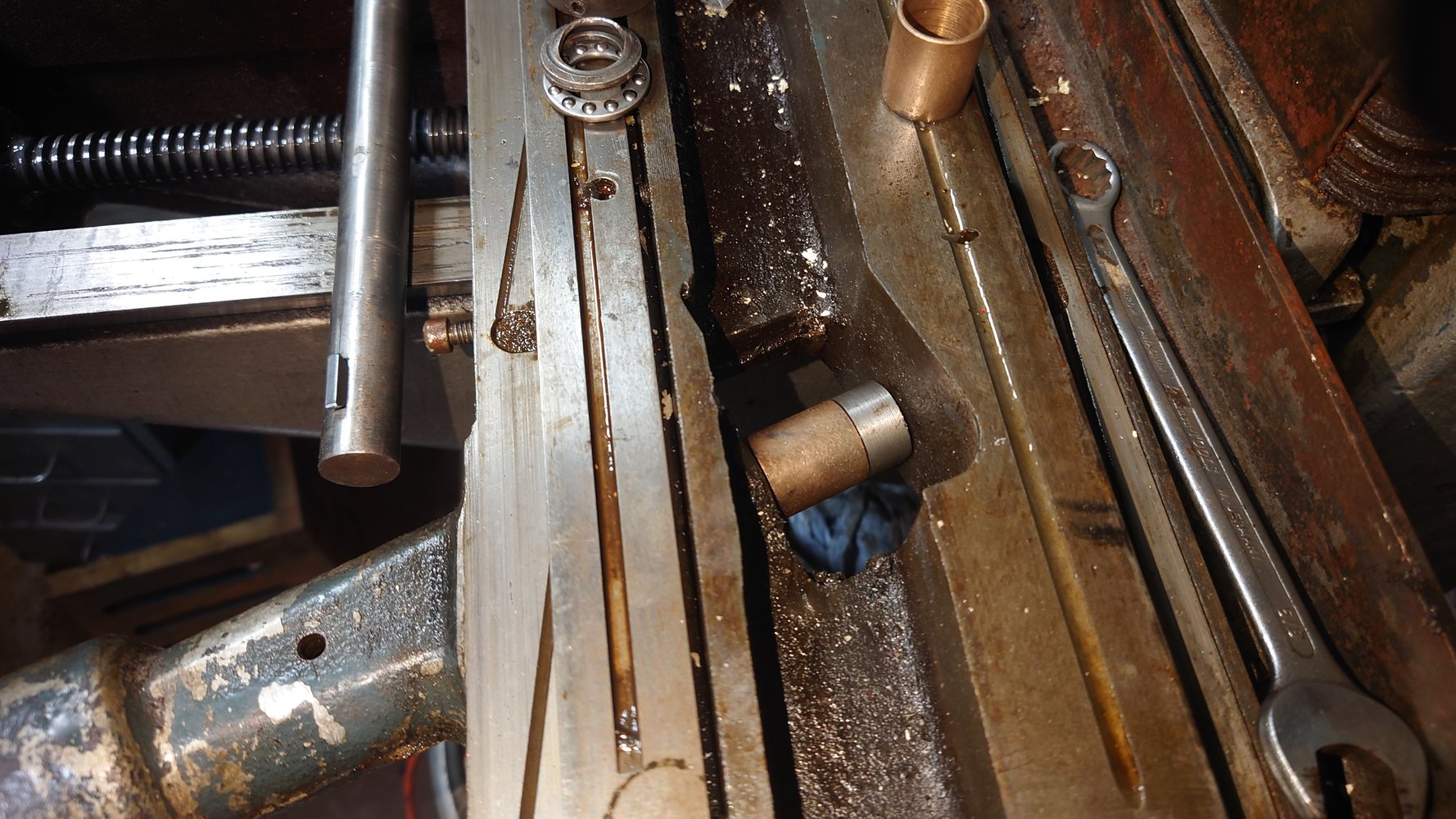

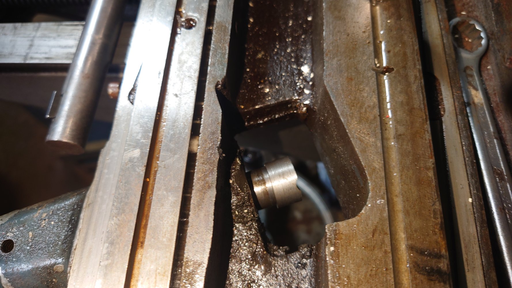

I needed to change a couple of bushes in my Eagle surface grinder with very little access.
I made a mandrel and used a slide hammer to drift out the old bush and install the new. It was tight but not crazy tight but I did need to ream the bushes to size after.
The mandrel was a good fit but not so tight it would bind in the installed bush.
I'd check the id of the stub and the od of the bush before going any further.

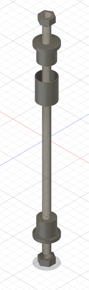

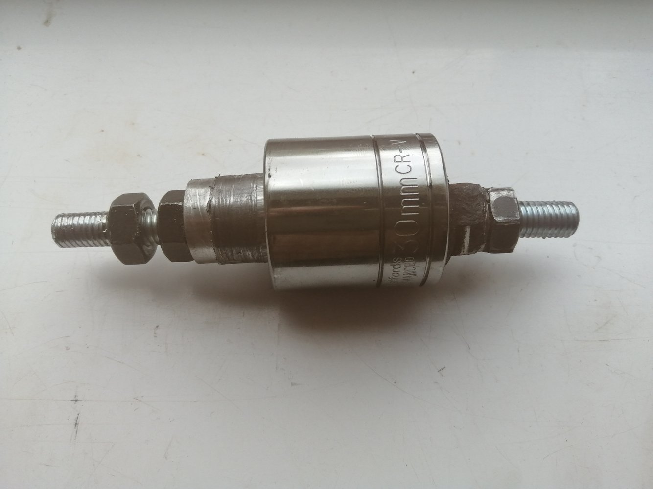

Can't you use a long piece of studding and pull them through from the outer ends?...Thanks Dcal. The casting measures 23.10mm, the bushing 23.17mm (after several attempts on each with the calliper). So about .0028" bigger. There's a slit in the bushing with a slight gap to close on the steel outer layer (brass/ bronze inner has none), so I guess that should compress. Does that sound about right? I'll have a go with the setup above later today, if I get a chance.
