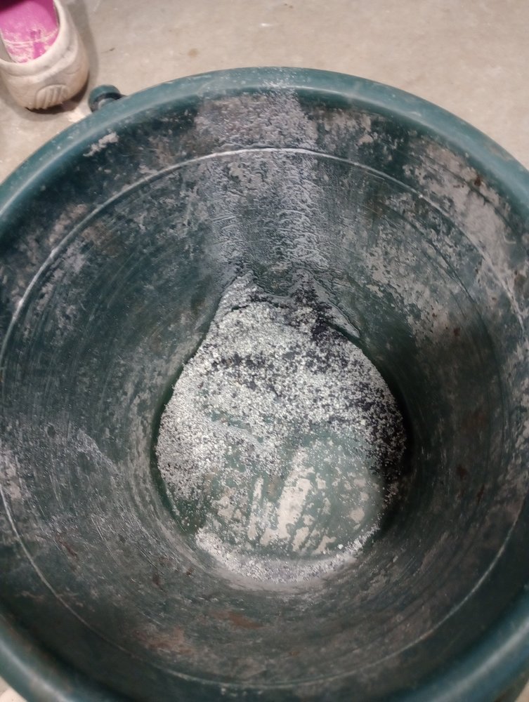

dobbslc Member Messages 14,166 Location Hertfordshire UK Dec 4, 2023 #41 Do you think the boiler has thrown the fault code now as the thing wasn't able to get into condensate mode before you sorted it out?
R RaceDiagnostics Member Messages 3,641 Location Broughty Ferry Dec 4, 2023 #42 dobbslc said: Do you think the boiler has thrown the fault code now as the thing wasn't able to get into condensate mode before you sorted it out? Click to expand... That's exactly what I was thinking, it's now operating much better and the limited slow drain is being overwhelmed.
waddycall Member Messages 2,089 Location Cornwall Dec 5, 2023 #43 But did you flush the crud down the drain?
R RaceDiagnostics Member Messages 3,641 Location Broughty Ferry Dec 5, 2023 #44 No, I did all the flushing with a bucket under the boiler. Whatever is down the pipe is what's been accumulating over the past 14 years.
