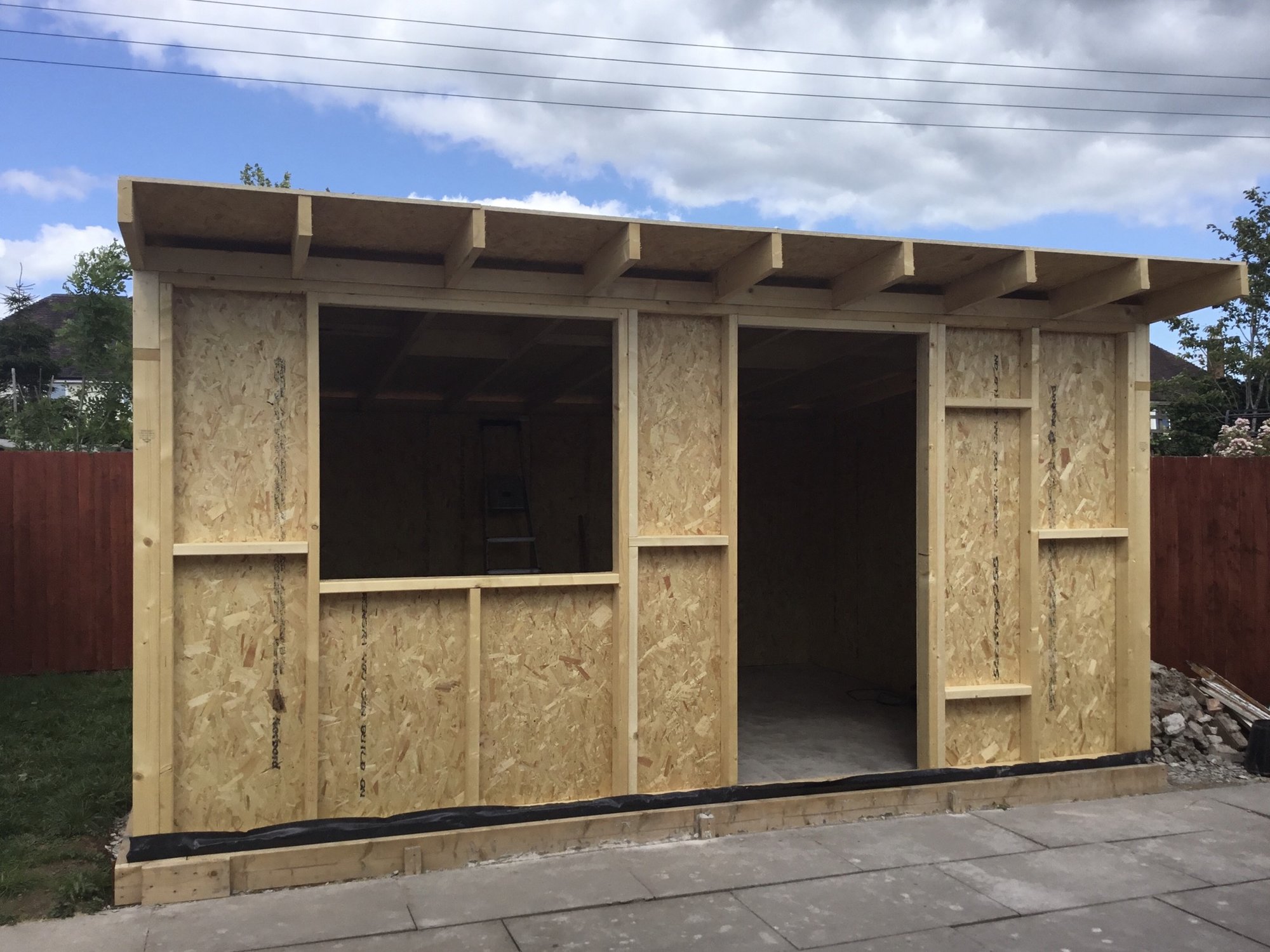

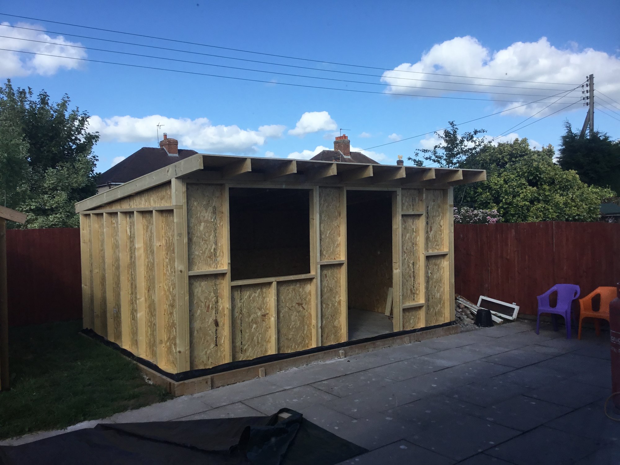

This is a speedy build .
Predictably, I made a cock up. I had planned to leave the OSB a little long, so it would over lap a 2 x 4 I planned to screw along the front. But I cut it flush. I’d like to have a little more than just a plain flush white board along the front, so a narrower plank, maybe 2 x 3, with the rafters trimmed at 45° underneath might be the trick.
View attachment 240219 View attachment 240220
@Morrisman ,how much nicer to look at your workshop than neighbors,plus gazing at it will breed encouragement.top job.
I’m still not sure what type of roof to fit. Felt, or steel. It is something I will never see, bungalow and all that.
