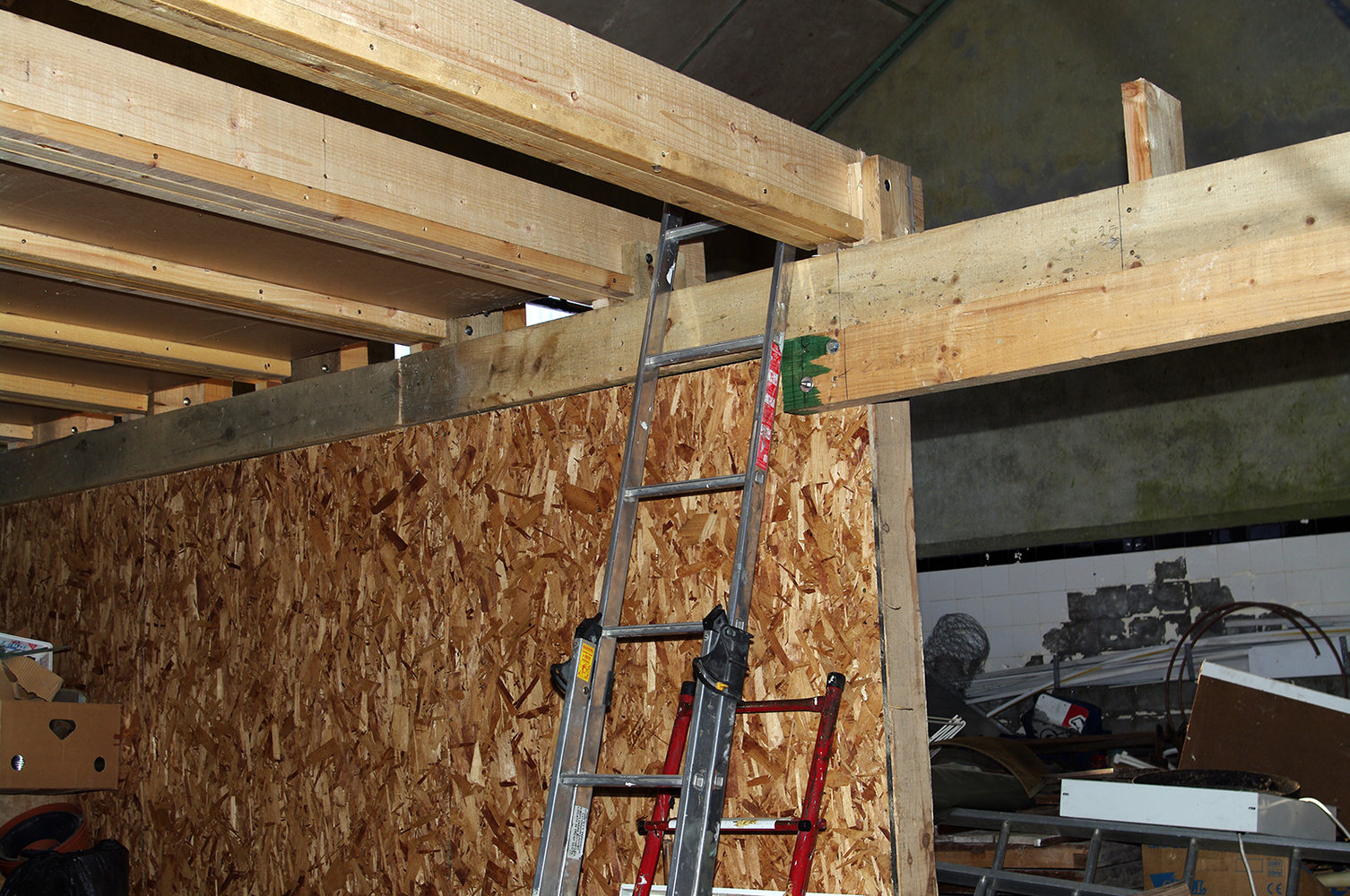

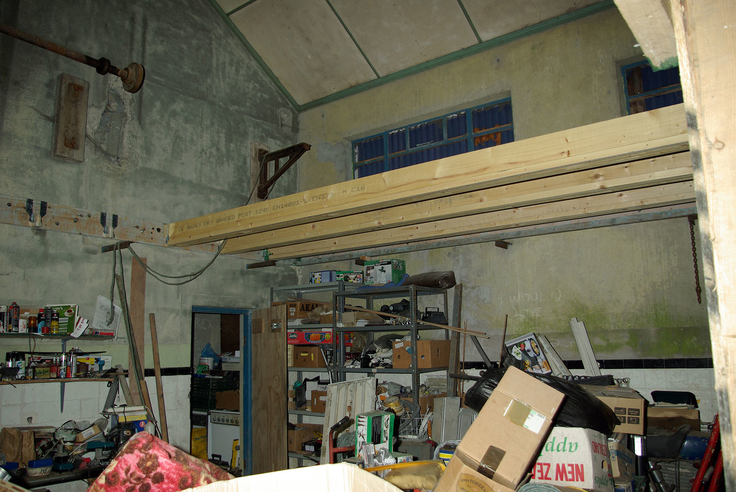

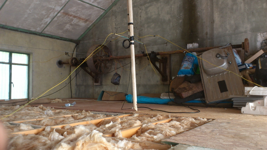

I made my own.
5m long 2x8" and paired up with 2x2 on the bottoms.
Supported in joist hangers at one end and resting/bolted/nailed to the top of the dividing wall at the other.
The 2x2s were glued and screwed every foot or less.
The end result was a ceiling with no sag and when I laid the floor upstairs there's no bounce at all. The addition of the 3/4" ply flooring made the whole thing rock solid.
