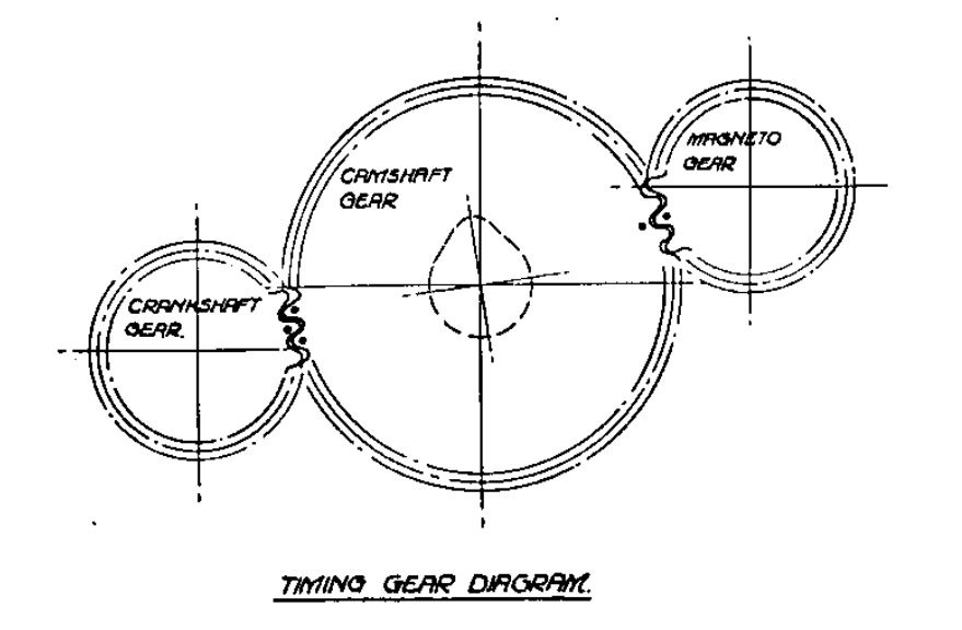

A lovely job, well done. How did you work out the ignition timing, to know the mag was a tooth out?
Found an old manual for it and as @Seadog says, just line the dots up, turn the magneto to the impulse trip point and back it off until the drive dogs engage
