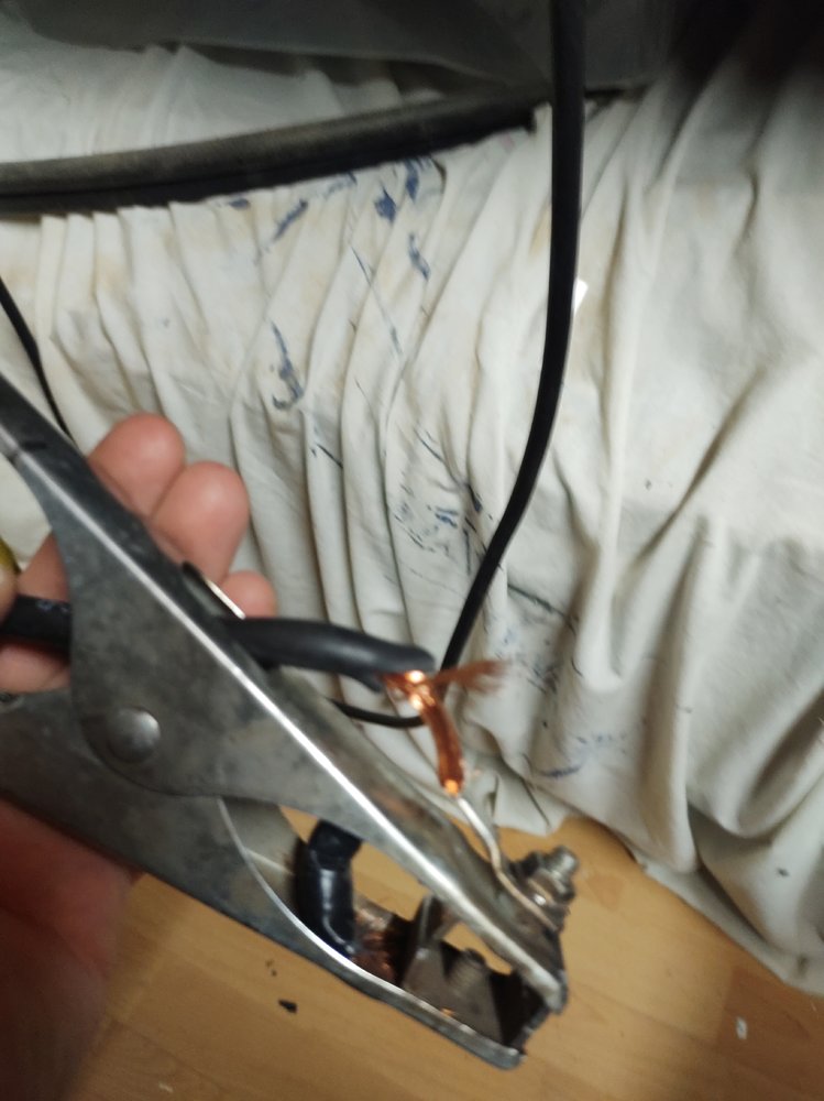

Arrr, the connections are all tight and clean looking... Perhaps all this hassle is just knackered (/rubbish) cables then! Fingers crossed!With very thick cables and solid bolted connections, the high-current secondary circuit should be showing resistances of milliOhms. From Ohm's Law, V=IR, so if the welding current is 30 Amps, a 0.2 Ohm resistance will drop 6 volts, and 0.3 Ohms will cause 9 volts to be lost.
