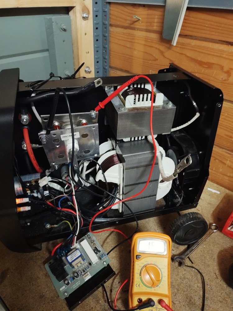

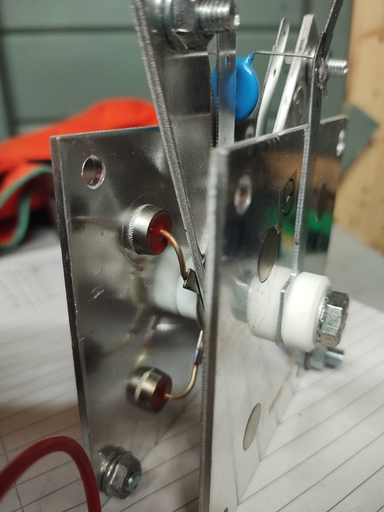

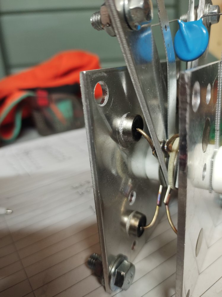

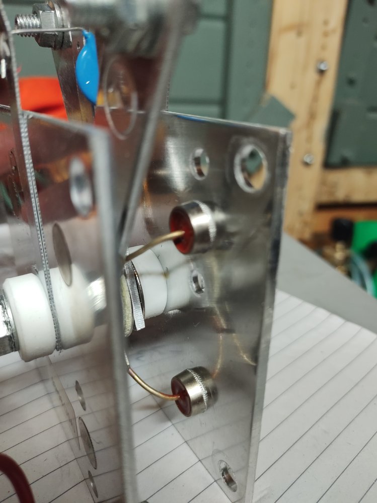

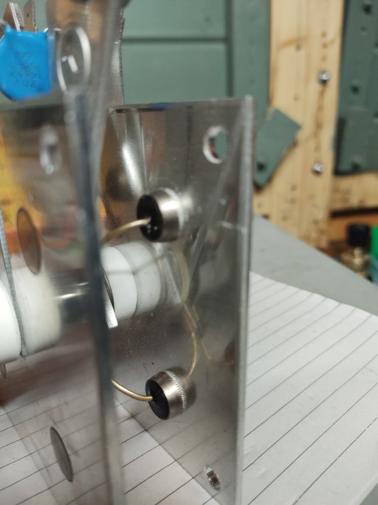

The diodes are press fit into the plates, in 4 parrellel pairs and soldered together where they join the 2 inputs from the secondary coil. I didn't want to destroy anything in testing so tested the 4 paths through the diodes leaving them paired up.When you tested the diodes did you do both plates of the rectifier as you only gave four readings

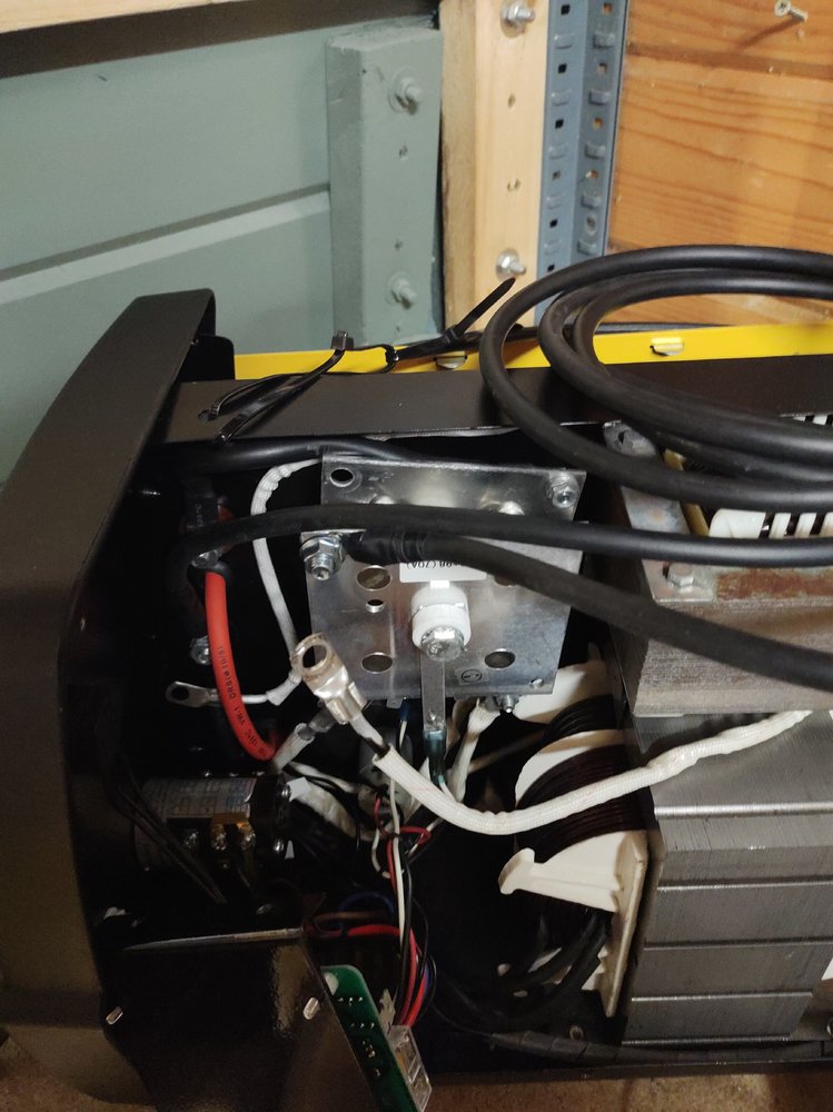

There are probably thin red & black wires with push-on tags taking the rectifier output to the wirefeed motor via the speed controller. To fully isolate the rectifier output, one of these wires should also be disconnected.Maybe you could unbolt both the positive and negative output wires directly at the rectifier, and check if the voltages are still so low there?

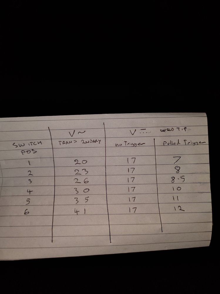

Will unbolt the rectifier output wires and test again.Thank you for the voltage test results. With from 20 to 41 volts, the AC outputs from the transformer secondary look OK, if a little high. However, the DC outputs from the rectifier are way down - 7v to 12v ! At first sight, this means that the rectifier has failed, and this happened by coincidence when you were fixing the gas valve in the torch.....
I was wondering if the diodes could pass muster with the test power from the multimeter but maybe short open under the power from the welder in operation? Is that a thing?!...
I was also wondering if the filter could be at fault.
Haha I no stranger to seeing long forum fault finding missions to the end :-)Yes, that is a 'thing', as the meter's inputting only 9 volts. I have had that diode failure mode before, once or twice.

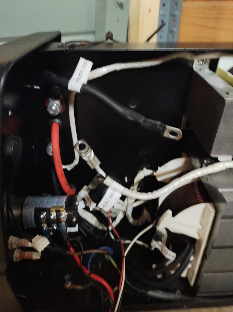

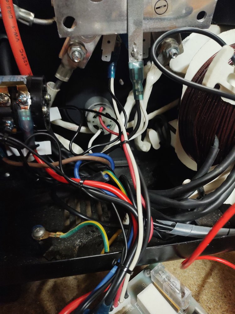

The small PCB-mounted encapsulated transformer gets AC power when the welder is first switched on. The output, usually 12v or 24v, is rectified and fed to the coil of the on-board relay via the torch trigger switch. The contacts of that relay send AC mains to the main transformer. It is basically an auxiliary power supply, rated at 1 or 2 Watts, responsible for powering-up the main welding output. That is all it does.There's a small transformer on the control board with output to the motor positive (red) wire, and a white wire to the motor negative, this also T's off and goes to the rectifier... I have no idea what that game is all about?!
The inductor/choke/filter is just a coil of thick solid wire on a laminated core. They almost never fail, and could not cause the faults seen.I'm tempted to bypass the filter for a welding test
The varistor ( or Voltage Dependent Resistor VDR or Metal Oxide Varistor MOV ) is used to suppress high-voltage spikes, caused by the inductance of the transformer windings, and prevent them from damaging the diodes. It offers a high resistance to normal ( low ) voltages, but the resistance drops when it sees a high-voltage spike ( e.g. 100 - 200v ) and it shorts the spike.The blue Varistor doesn't look damaged / scorched or anything but could that be at fault?
Does anyone know what it's purpose is here?

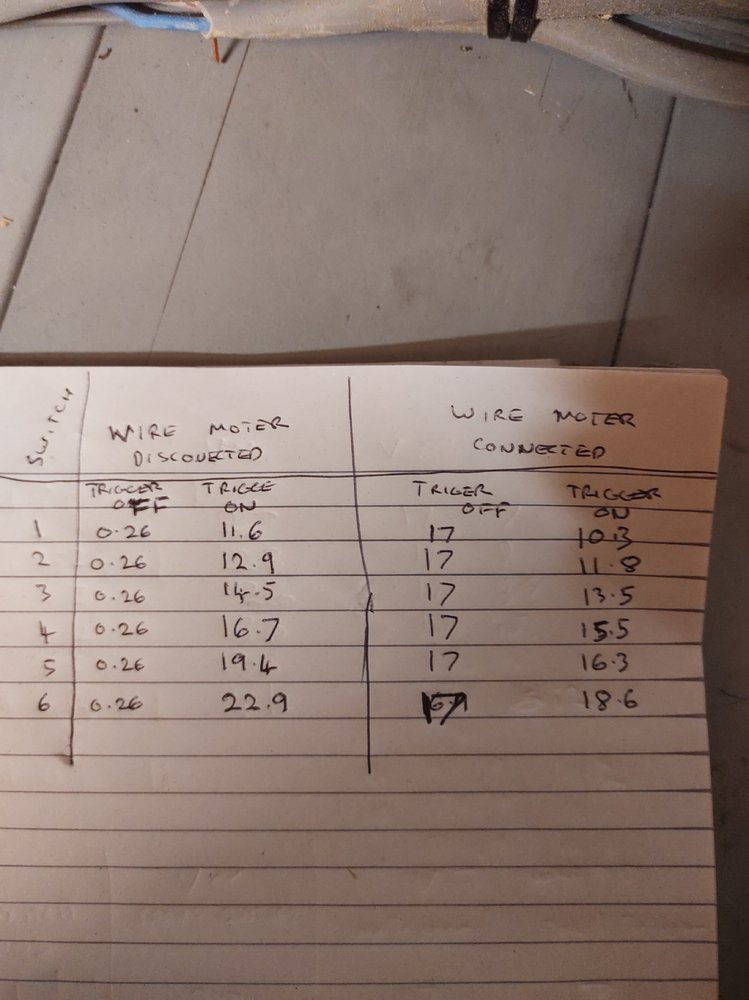

I can't see how the voltage can drop on the way to the torch:The DC voltages measured at the rectifier output and listed in post #28 - from 11.6 to 22.9 volts with the wirefeed motor disconnected, and from 10.3 to 18.6 volts when it was re-connected - are much higher than the torch tip voltages shown in post #21 - from 7v to 12v. The former are still low, but enough to weld with.
Did something change, or is voltage being dropped on the path to the torch?
Digital meters will register voltages whilst drawing very low currents - picoamps. Measuring the AC secondary and DC rectifier voltages across a load resistor ( such as 3 x 12v 60W car headlamp bulbs in series ) may help to clarify what is happening. The load current will only be 5 Amps, but that may be enough to show if voltage is being lost across a high resistance somewhere.
With very thick cables and solid bolted connections, the high-current secondary circuit should be showing resistances of milliOhms. From Ohm's Law, V=IR, so if the welding current is 30 Amps, a 0.2 Ohm resistance will drop 6 volts, and 0.3 Ohms will cause 9 volts to be lost.I can't see how the voltage can drop on the way to the torch:
