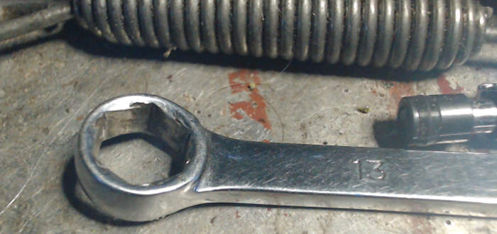

If it was just a 13mm would a flare nut spanner not have worked?
I've a set of AF spanners that are years old and have obviously worn a bit, the 1/2" is a great fit on worn 13mm heads, 5/16" is good on 8mm as well.1/2"AF might have gripped it.
Probably worth replacing the idlers just now too.
