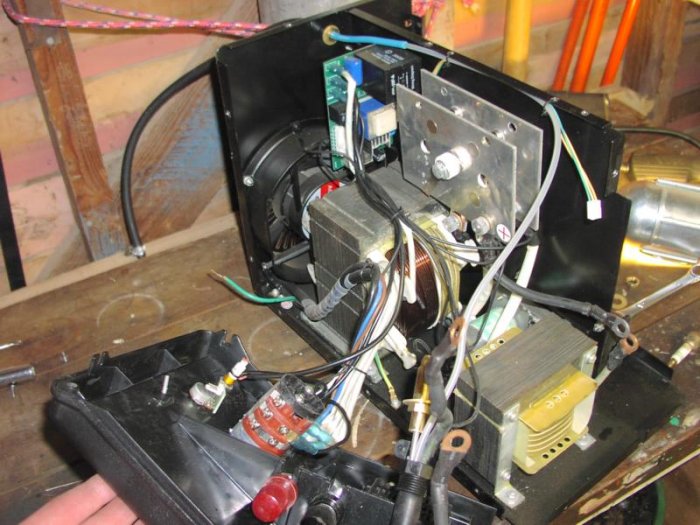

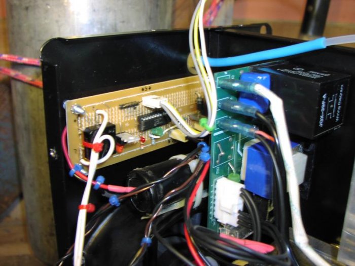

Anyway, investigating the circuitry showed that the wire feeder is fed power from the positive output of the welding supply. This goes into a very crude PWM generator (basically a transistor with variable bias) to adjust the speed.

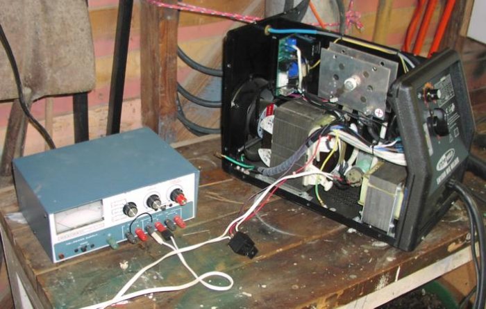

For a test, I cut the wires to the feed motor and wired them into an adjustable bench power supply (0-25 volts) through an automotove relay (turned on by the original feed motor voltage). This worked rather well and I think it welded better with the more smooth feed motor voltage. I'm contemplating building a new regulated power supply and speed control to run the motor, totally independant of the arc voltage. Just wondering if this is going to cause any other problems?
