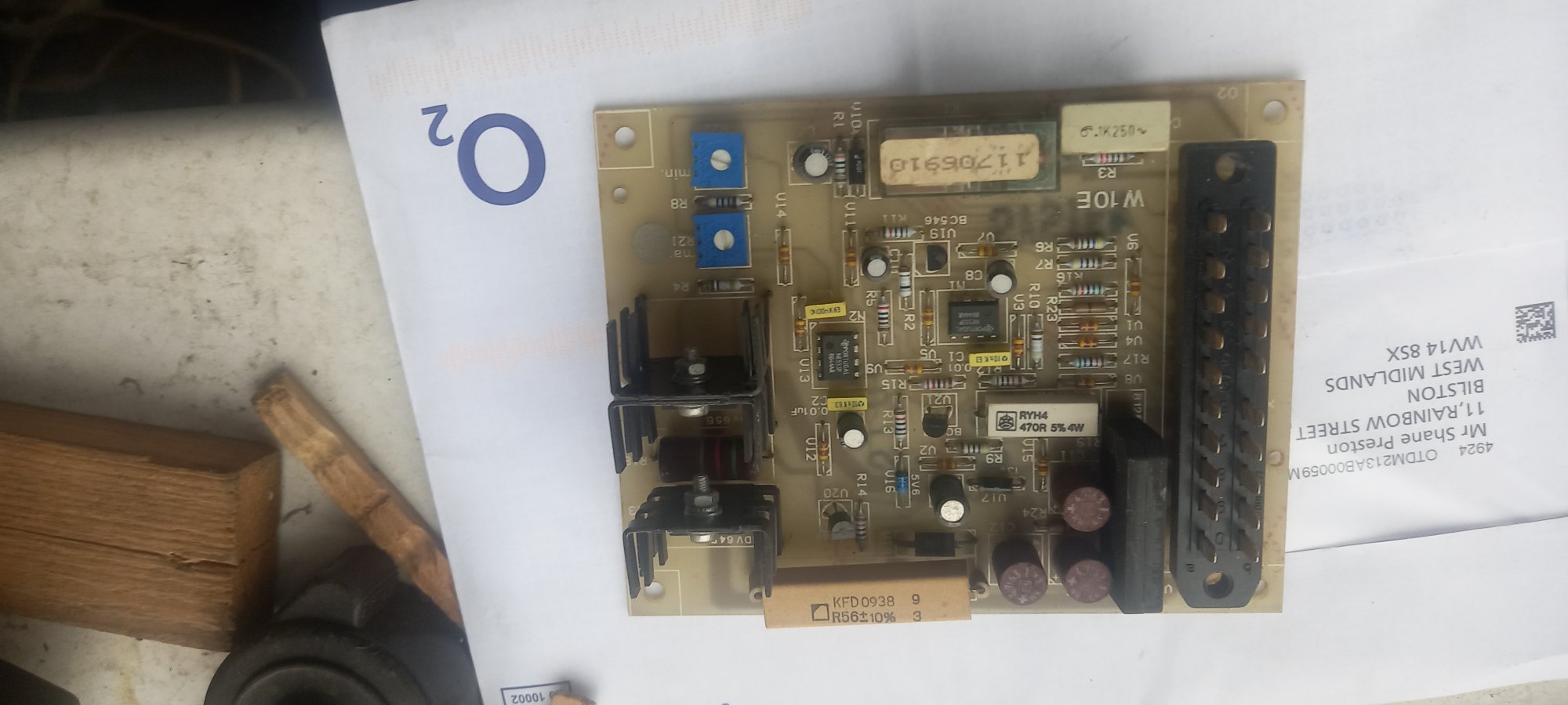

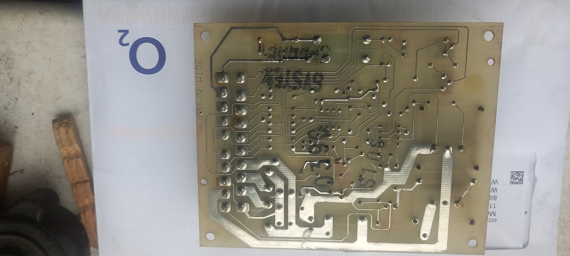

I still think your Tradesmig is fixable. You could start by unplugging and removing the PCB to check for dry soldered joints or corrosion.

Thank you for the photos of your PCB. It looks fine, no sign of corrosion and the solder side looks good and shiny. So again, the fault could be in the front panel controls, or the wiring. I will look at the general layout wiring diagram that I linked to in Post #15 and suggest some troubleshooting steps.
