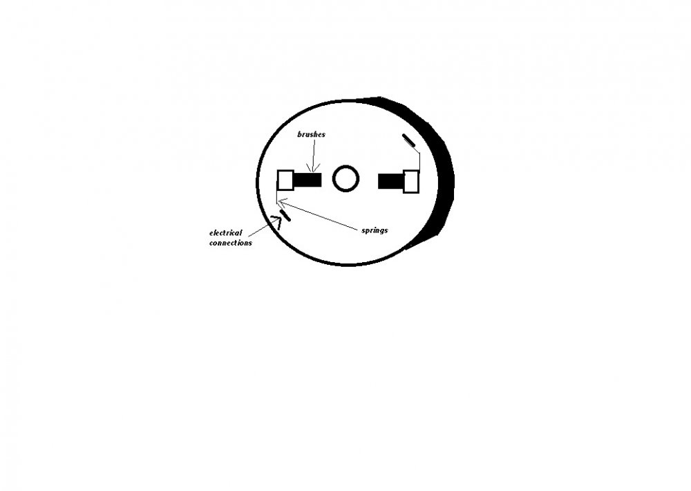

The "tags" can be bent back allowing the white end cap (remove all solder with a file) to be lifted off. Note the brushes will/maybe attached or fitted to the white end cap and will need to be pushed back (very thin screw drive) as the cap is refitted.

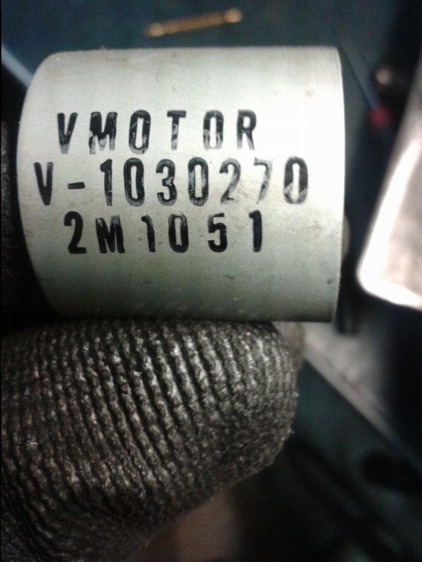

Then a light bulb switched on....... its the ****** motor itself! Inspecting it i could see no damage other than what i had done by clipping wires but i then turned the small cog by hand and there it was. The tiny little stall is coming from the motor itself.
Well at least thats no 70 bucks, i can get one for a ten spot plus postage from clarke, probably cheaper on the bay.
Ill order one up (if i can find one), install and report back all fixed (he says with crossed fingers)

back to the garage and stripped the motor. couldnt see anything wrong but i see what you mean about the magnets. i have put it back together and will try a weld tomorrow night. ill upload a vid and you can see how it does sound better than before
Well, surprisingly, all the hard work seems to have paid off. It's all back together again and first welds are good. The erratic feed problem almost completely gone, i can hear it but not sure anyone else would. The weld beads themselves look good and I'm happy to start using it again.
