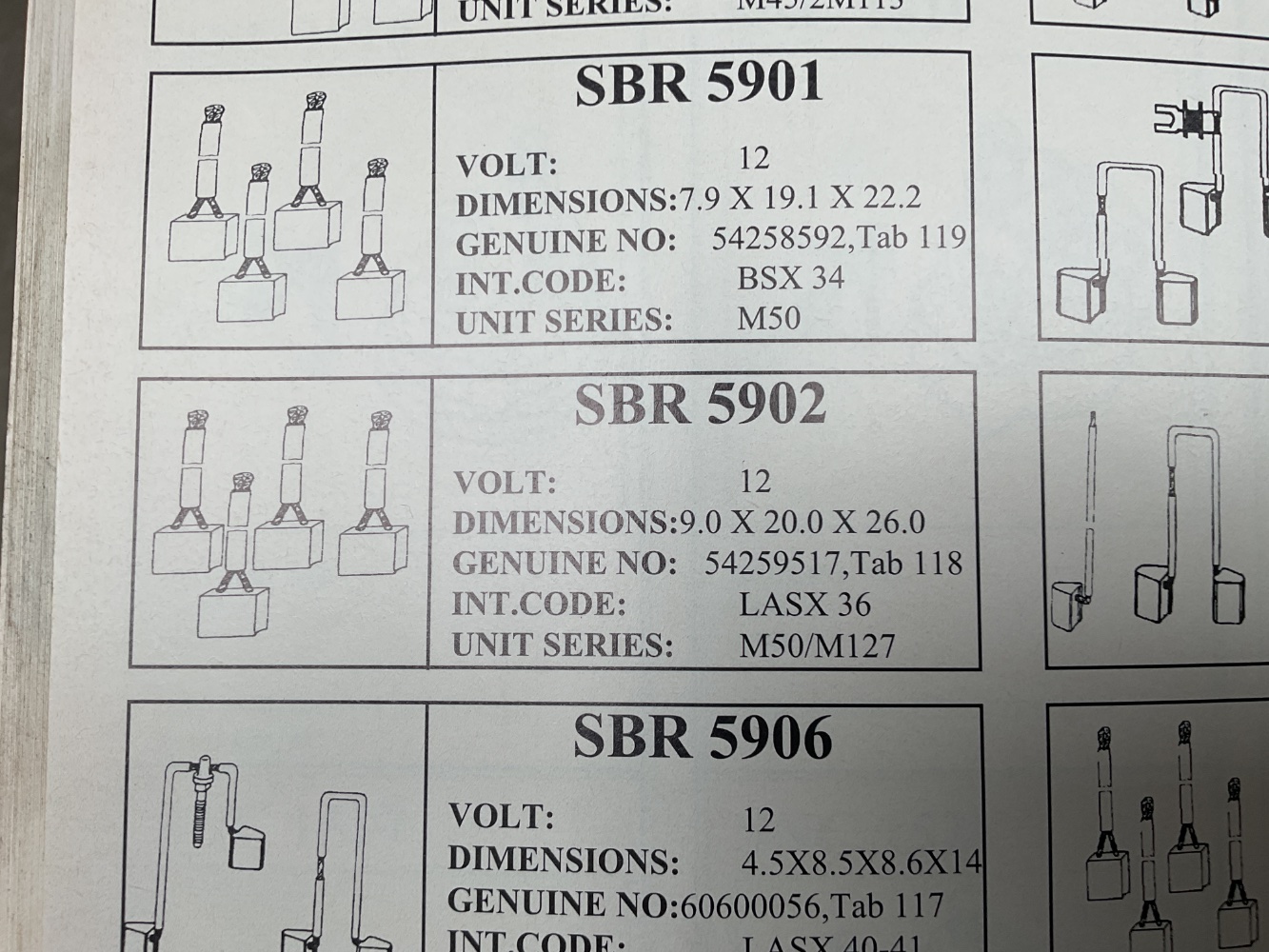

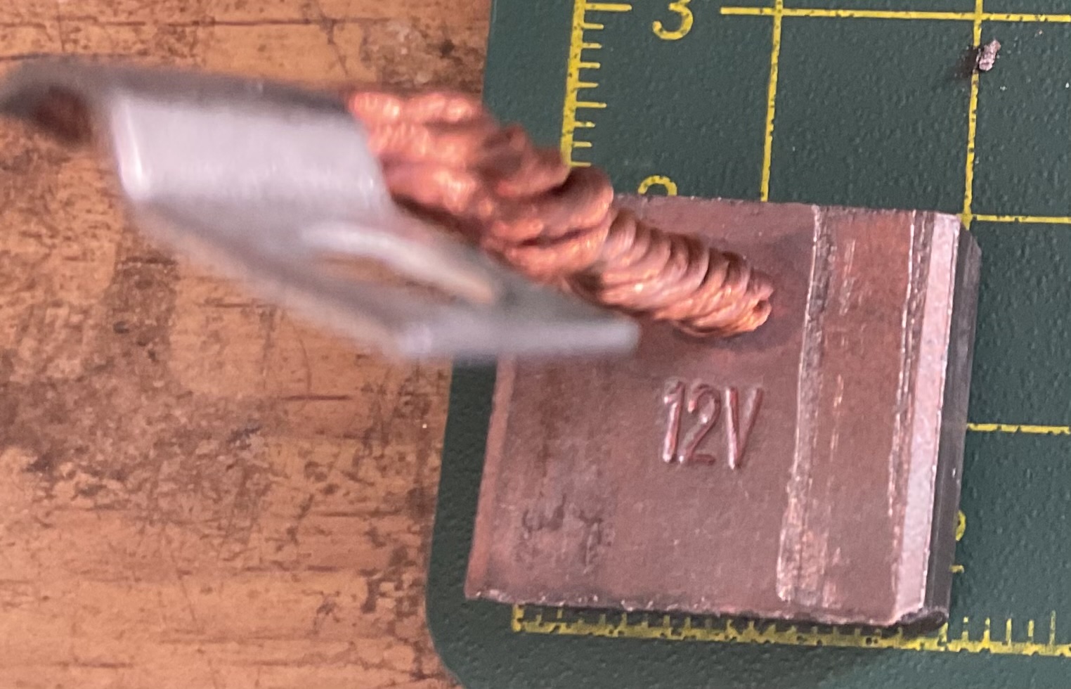

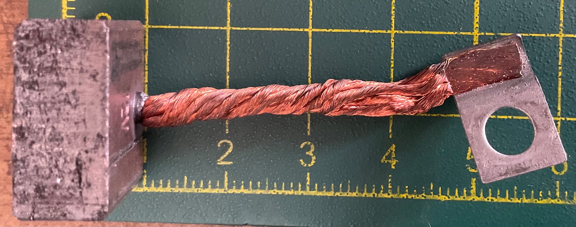

Superwinch EPi 9.5. I’ve looked high and low for 4 replacement brushes for the motor (Superwinch have gone bust):
They are 20x9mm in section, maybe 22-25mm long when new. Copper graphite.
Custom-made ones would be about £120 all in, but given the commutator had to be skimmed due to burning, may not be worth that kind of punt.
I’m very surprised I can’t find a generic set for a starter motor or generator, or even larger ones I can cut down. Any ideas/brushes lying about?
