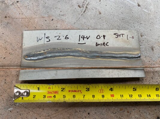

Another .6mm ist here, I am envious of anyone that can run a proper weld (not spot) on wafer thin gear with .8mm wire.

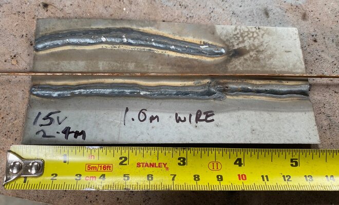

That's been my experience too, I also suggest that transformer welders struggle on thin stuff or at least leave a bigger weld that needs more grinding, they're ok at plug welding but doing butt welding, you need low amps obviously, but a stable arc, people think 0.6mm is the only answer on thin stuff, but with the right welder using 1mm wire you can easily weld 1mm steelA lot of welders don't have a low enough output to run 0.6mm properly. The good welders designed for car body repairs can use 0.6mm and go below 30 amps. A lot of cheap (or big) welders start at 35 or 40 amps or even higher.
