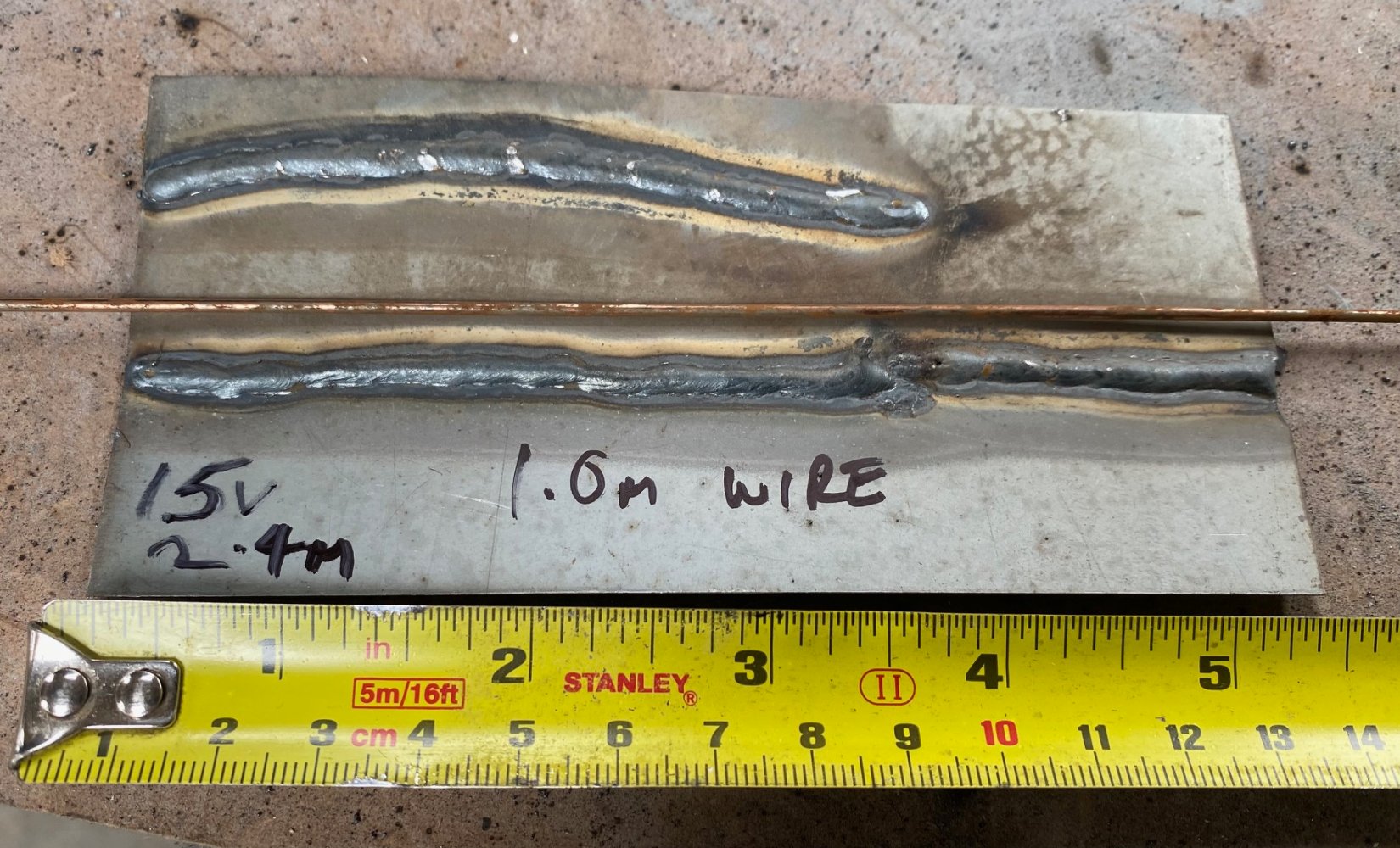

so is gas brazing , but if you compare it to tig its not too bad , the nice thing is that oxy acet kit is practically free these days , and once you have the gas set up it has many many uses.True,but mig brazing,costly

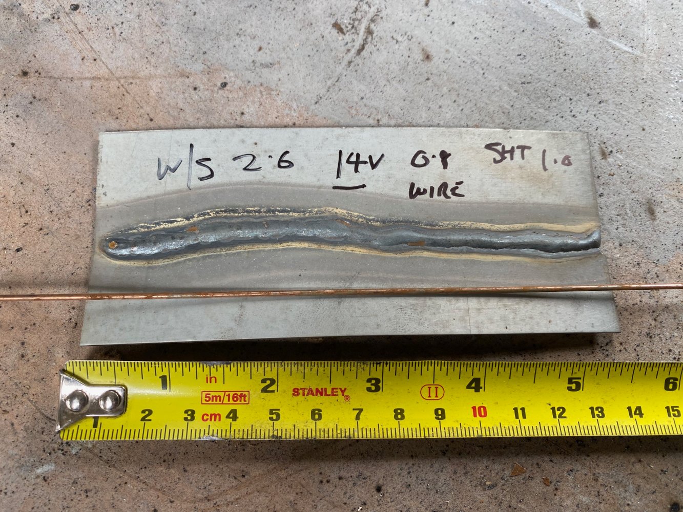

Another .6mm ist here, I am envious of anyone that can run a proper weld (not spot) on wafer thin gear with .8mm wire.
