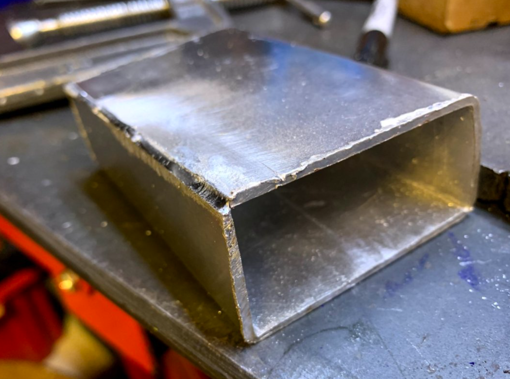

Test piece:
Folded box, that's going to be part of the extraction duct on the belt sander:
Just goes to show you get what you pay for - this is with the lumiweld rods.
As noted earlier, it needs a lot of heat. I wasn't getting anywhere on the box, then swapped to a newer calor bottle and it all came good.

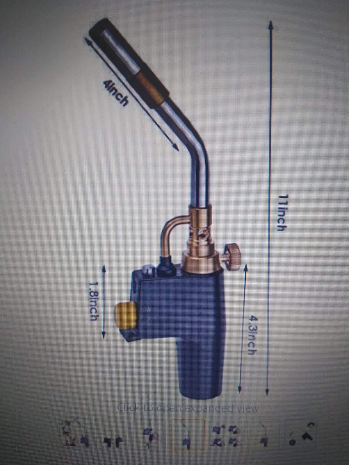

Probably time to get a mapp torch...
