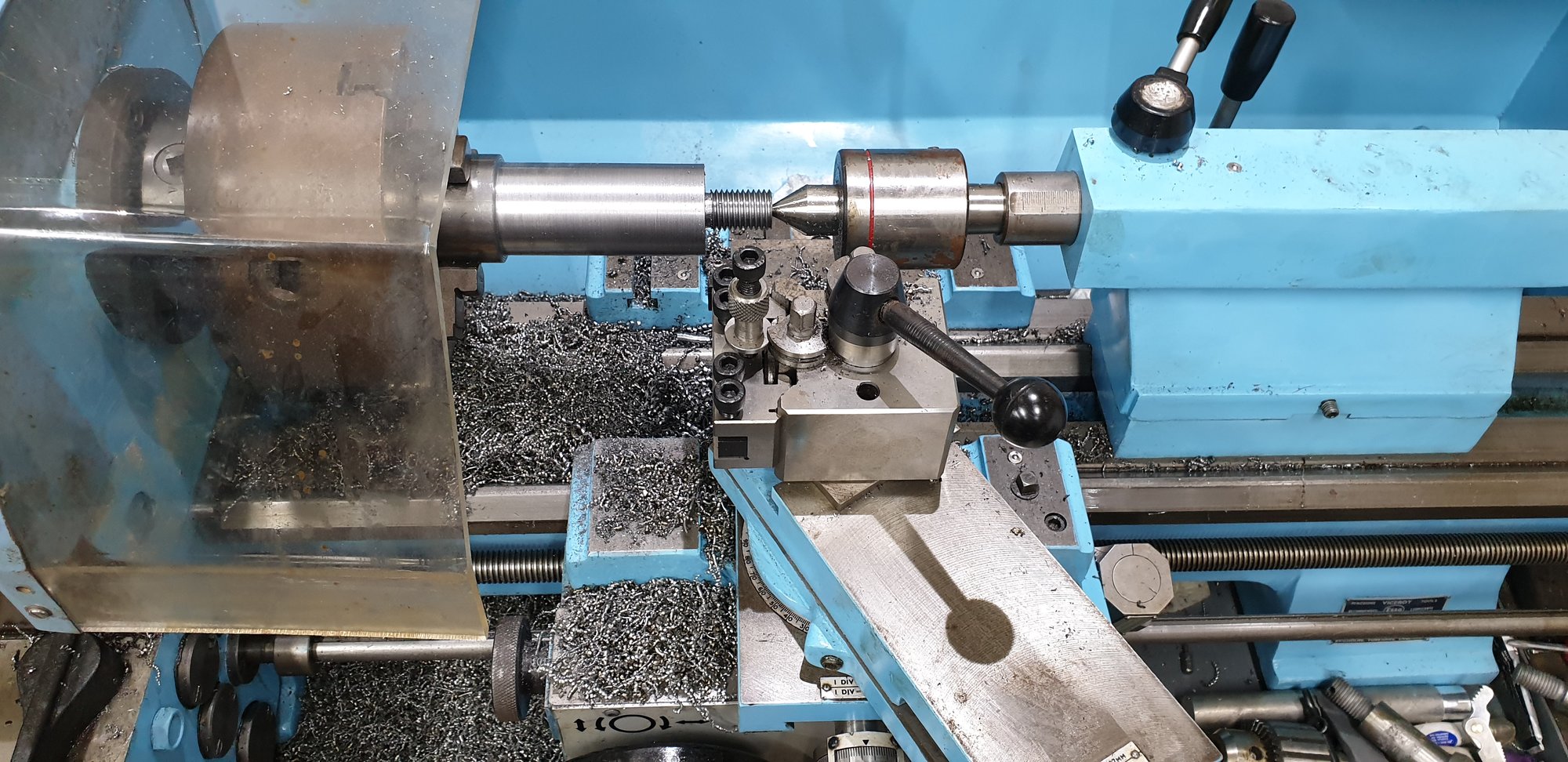

The compound is generally set to half the thread angle. So 30 degree for metric and unified, 27.5 degree for BSW/F/P.
For inserts it's common practice to dispense with the above and just feed straight in.
