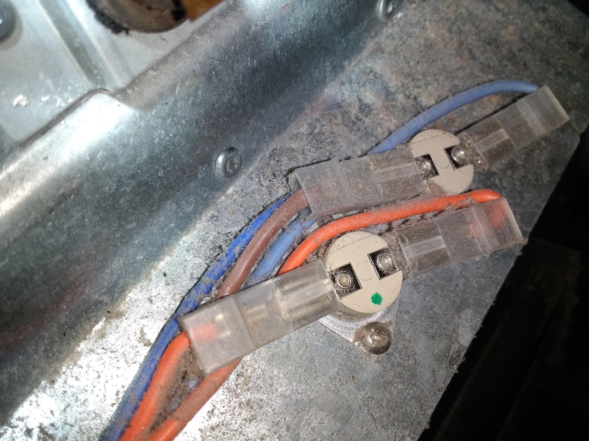

On my drier, which looks similar. There is a heating element with a series thermal cut out (non resettable) and the other one is a sensor which feeds back to the control PCB.
https://www.rapidonline.com/Catalogue/Search?tier=Thermal Switches&Size=20
If you think one is faulty they are a low-cost component, just need to match the temp range.
