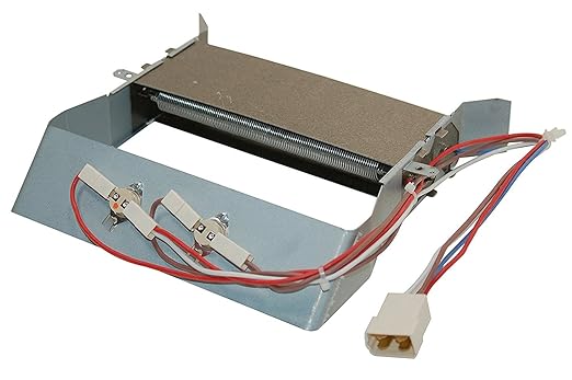

So we have one of those generic condenser dryers. I think it's an hotpoint, but they're all from the same factory.
It has an element pack on the back, with a couple of elements and some thermal fuses, which, I assume, auto reset.
The issue is that, somtimes the unit wont heat. A cold reboot seems to cure it some, but not all of the time.
But other times it's fine. So it's not something simple like elements gone.
Do those thermal fuses (well, I guess they're just temperature dependent resistors read by a micro somwhere, rather than fuses) age?
When you buy the replacement element pack it comes with the fuses, but I can't find anything wrong with the one I've got.
What do you reckon?
(And, yes, I've cleaned all the air ways, so it's not an air restriction causing overheating, fan is all fine, etc)
