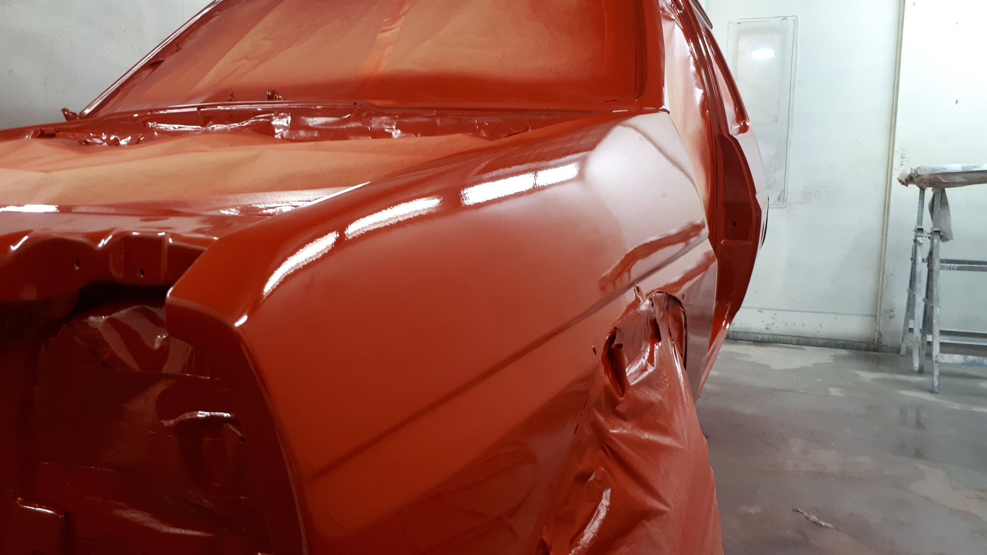

  8. Pigeon_Droppings2 Member
    Messages:
    2,426
    Location:
    london
    Definitely recommend Devilbiss guns.....the one we used was 20+ years old. I got very lucky and picked up a job lot of spray stuff for £100 on fleabay....in the lot was a brand new (still in the original box) devilbiss + service kits etc.
    As others have said....2 pack epoxy primer is the way to go. Epoxy Body 989 is now my favourite....it doesn't contain the nasty stuff (but you should always check the data sheet before using any 2 pack system) so can be used with a vapour mask (like 3m 4251).
    I would definitely use cellulose again....in a garage its hard to keep the dust down so if you do get any minor issues with cellulose you can fix them because you can blend new and old paint.
    The other recommendations I have is the thinner we used for the base coat.....it cost a fortune but the gloss was amazing (I can find the name if you want it). Also dolphin fine filler...does the job that a stopper does but it's a 2 part mix so a lot less problems when you paint over it.
    I didn't clear coat....decided I'd rather have the ease of repair as I live in a city!

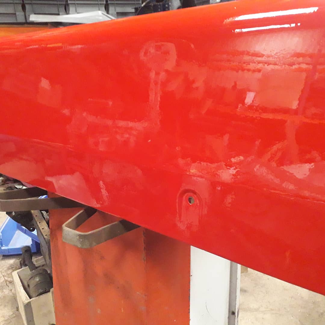

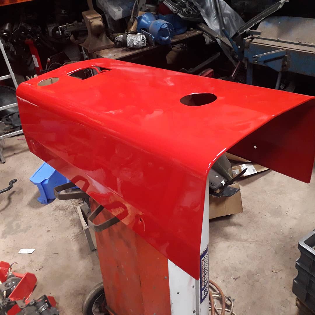

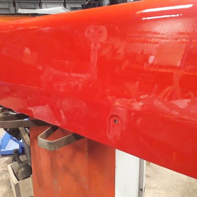

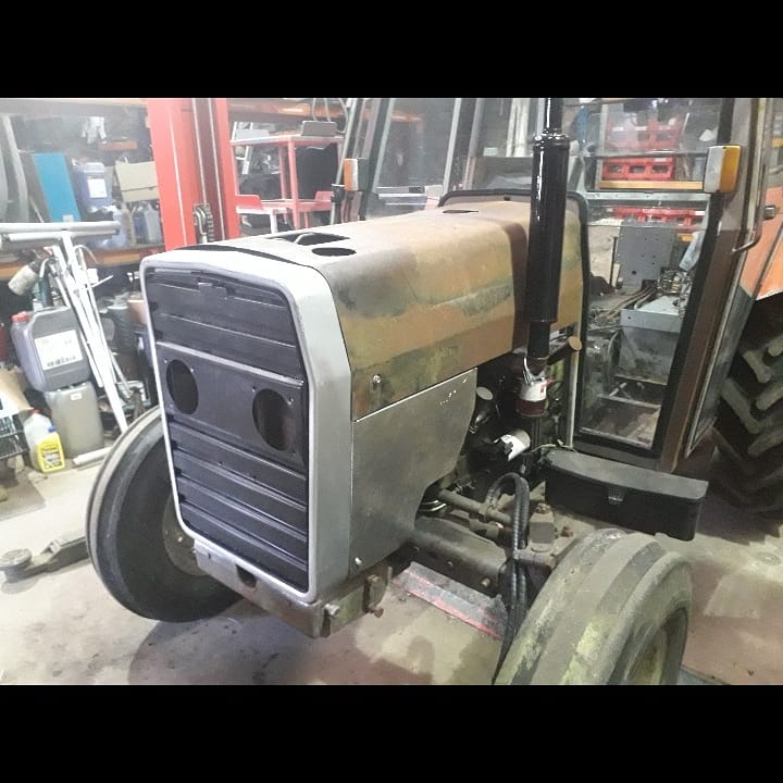

    I have been using a old (vintage) devilbiss suction at work of late.
    Using vapormatic singlepack tractor paint,
    And even with that a presentable finish is possible off the gun.
    Tractor which suffered a fire bonnet left outside to rust for 10 years, attacked with 9inch grinder and wire wheel, then red oxide then a fair quantity of paint can have decent results (even when painted at 90psi due to no regulator :whistle:)
