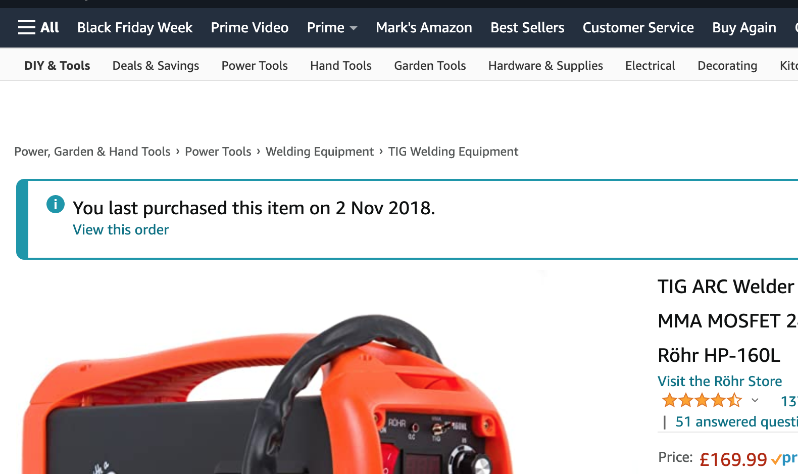

It was £139.99 when I bought it; the price seems to be going the wrong way. Been there; done that; no thank you. I'd be looking at the Sherman or something non-Rohr at least. Union Mart (who sell Rohr) give you £5 back for a five star review (I got the form when I received the welder). Be careful of that and those five start reviews like "quick delivery", "looks great", "husband is very happy" - yep, but who has actually used it.
Clicked that link to Amazon and the memories came flooding back when I saw the message...
...so I owned one.It was £139.99 when I bought it; the price seems to be going the wrong way. Been there; done that; no thank you. I'd be looking at the Sherman or something non-Rohr at least. Union Mart (who sell Rohr) give you £5 back for a five star review (I got the form when I received the welder). Be careful of that and those five start reviews like "quick delivery", "looks great", "husband is very happy" - yep, but who has actually used it.
There is one video about it on YouTube that I can see...
...so it does work I guess.
I never used the TIG function with the Rohr but did stick weld with it. Did it work? Yeah (for stick welding at least). But when it was on the shelf with a couple of other welders I never picking it after a week of ownership. I never got round to organising the gas so it just gathered dust. When stick welding its dial was very inaccurate for me (I compared what a DC ammeter said to the front display and it was a good bit off). I had to set the dial to 142 amps for a 3.2mm e6013.

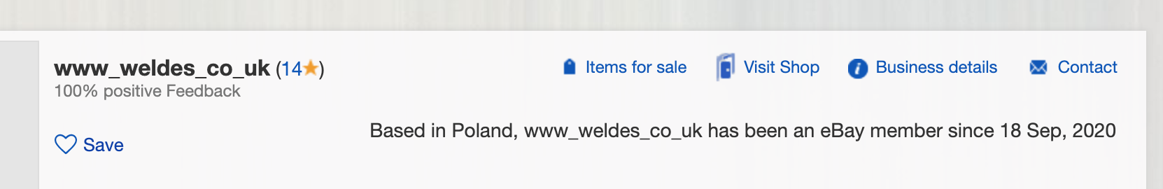

the welder from weldes is shipped from Poland which I didn't realise and there is a two week delivery, which is quite close to Christmas
].Hi, sorry to bring this up again, the welder from weldes is shipped from Poland which I didn't realise and there is a two week delivery, which is quite close to Christmas, just searching on eBay, there was this, has warranty, HF ignition, etc, no pulse, worth looking at?

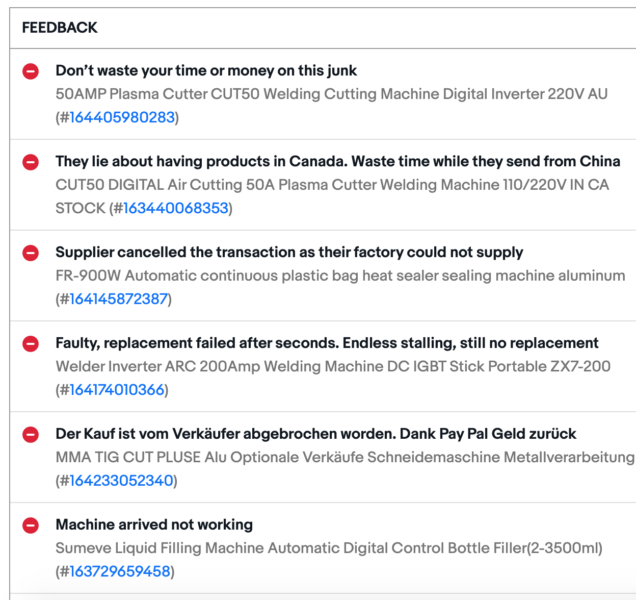

I've already shared my experiences far and wide about Parkerbrand, needless to say avoid unless you are willing to accept it may or may not last a pack of rods, either way you have no comeback if it fails.
Should be before Christmas@www_weldes_de can you help confirm the delivery time for a Sherman 202p? Will it get to the UK in time for Christmas?
