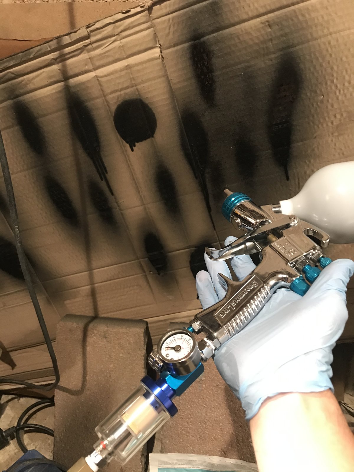

E Edward Yemm Member Messages 469 Location Forest of Dean, Gloucestershire, England May 27, 2020 #61 Played around with the regulators a bit. 33psi fully loaded and 29.5psi when compressor cuts in. I’d say that will do.
carbon Member Messages 3,060 Location S. Glos. U.K May 27, 2020 #62 Check how much water collects in the bowl and drain regularly, ideally a large bore hose between the tank and the regulator.
