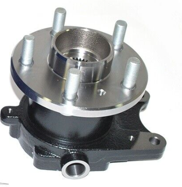

I'd simply file the holes for clearance if the wheel is located accurately on the centre diameter. It won't take more than a few strokes with a round file to make enough clearance. That would save the hassle and expense of drilling 5 more holes.i found this pic on ebay of one of the hubs, using a tape measure the hub centre looks less than a mm to big to go into the wheel so that wouldent be to difficult to machine down leaving plenty of material and there is plenty of room between the studs to machine 5 new holes at the correct pcd that way i dont have to mess with the wheels
