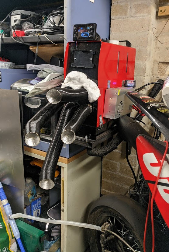

Stoopid second hand stuff.I use one of the cheap 5kw Chinese diesel heaters.
Full chat seems to get about 25-30 degrees above ambient in my garage size completely uninsulated workshop (with plenty of holes to the outside world).
When running flat out it uses about 0.4-0.5L an hour. I used to use kero but have switch back to diesel as mine seems to produce noticeably hotter air when running diesel.
