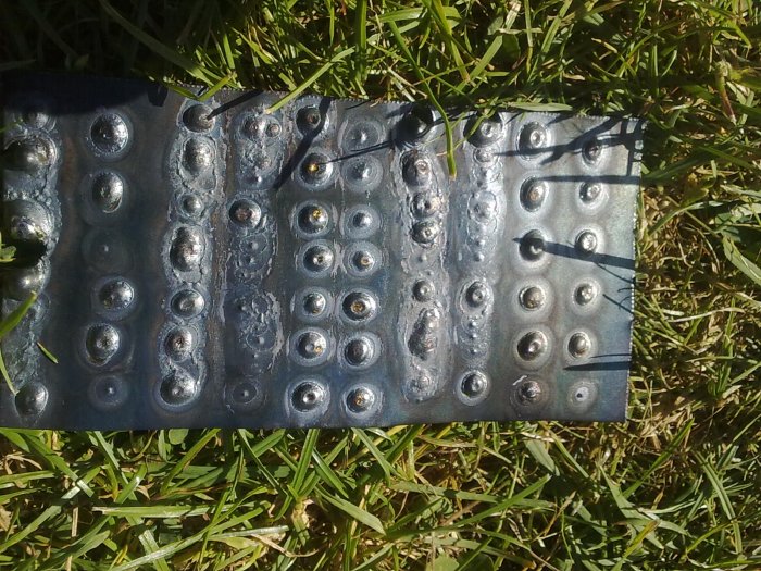

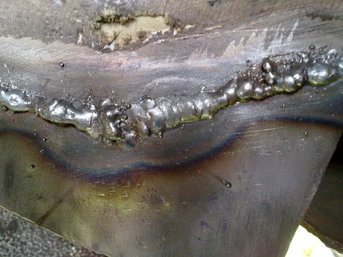

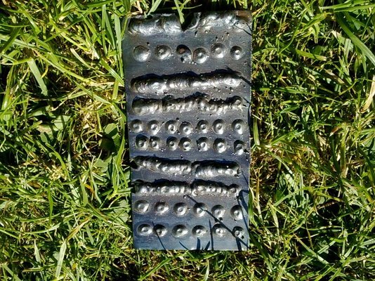

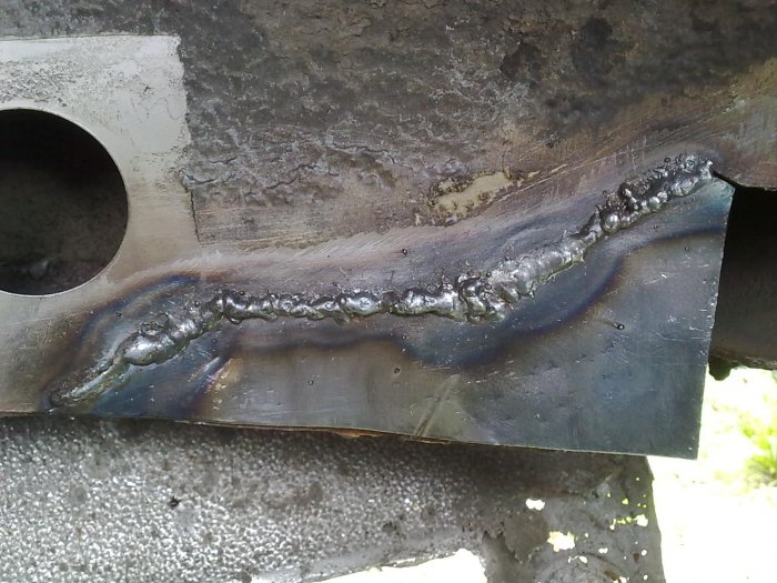

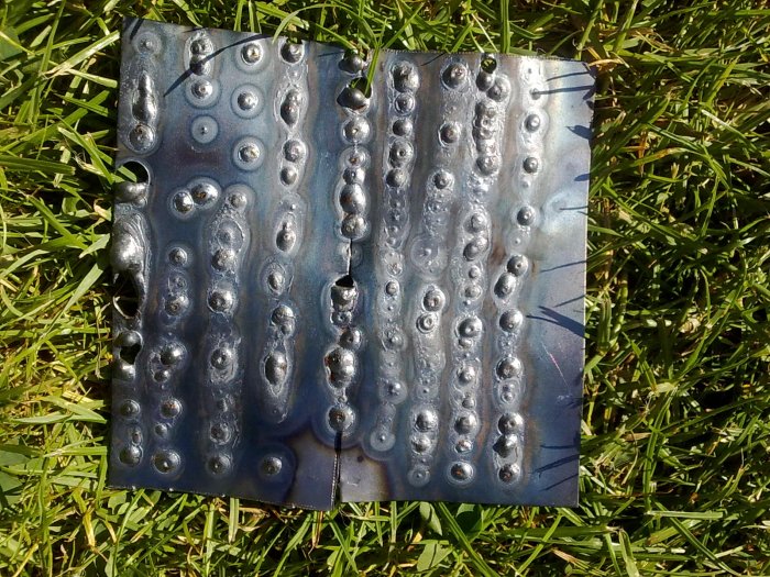

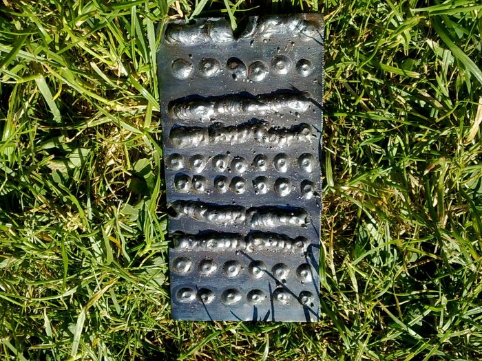

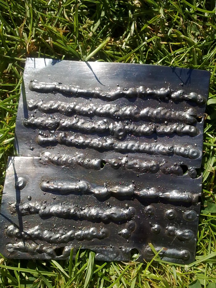

i am using an argon mix and i dont have a garage to get inside
if you look at my gauge i had that set to 8 bar instead of 2 yesterday and still had the brown residue
im doing butt welds and the inside of the original panel has waxoil on it would that have any effect
I'm not familiar with those guages but stand by my previous comments that without knowing exactly what flow rate you have it's hard to know if you've got a problem elsewhere - it could be waxoil coming thro the weld but I don't know.
I have two argoshild guages and they have l/min on them - both need to be set at differnt places and for either of them the actual flow thro a flowmeter isn't the same as the guage suggests - that's why I use a flowmeter - if I'm inside the garage with windows and doors shut I can reduce the flow down to 7 l/min and it seems fine - doors and windows open in this lovely weather we are having and I need to turn the flow up to 10 l/min
