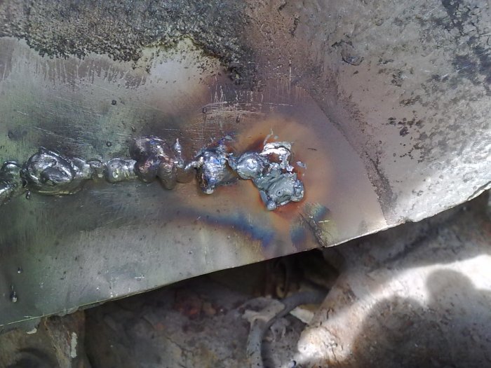

if i have my welder on min1 it seems like i dont get much penetration but when i put it on min2 i get penetration but also burn through a lot

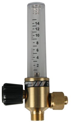

im going to have to get myself a decent size bottle as them little things dont last long
yes i am welding outside but there was no breeze

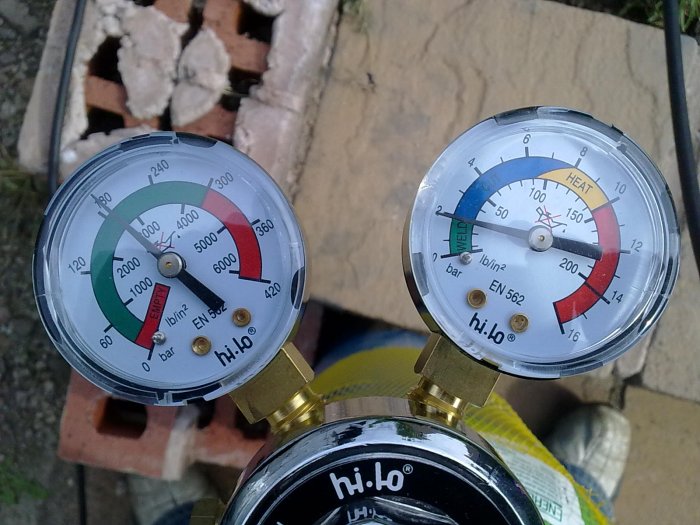

and the gauges i have have readings in bar with coloured sections and headings
weld is upto 2 bar but it didnt sound like i was getting a lot of gas so i had it on 8
do you think it was too much gas
