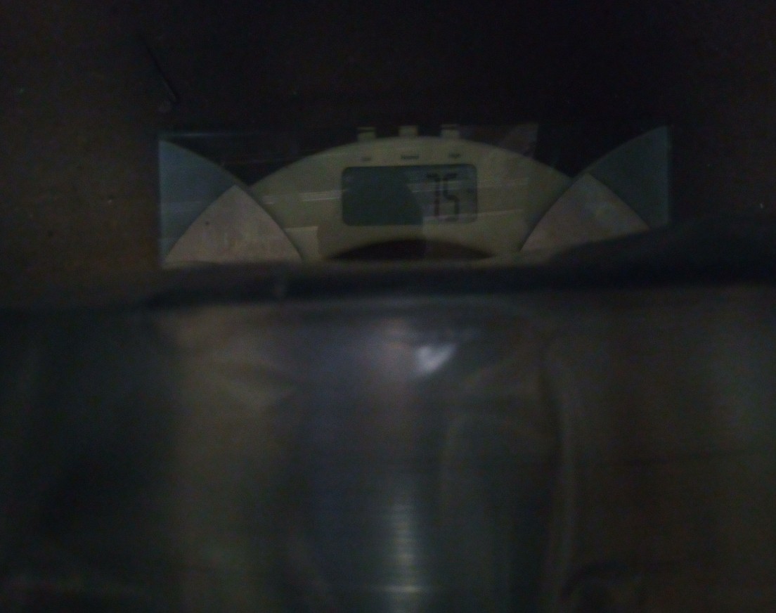

    Not sure if it is the same with steel or not as I never use it. With Aluminium however you often only get 6kg per reel with the cheap crap but with likes of Esab or EWM you get 7kg, that makes it not much dearer than the likes of Super6.

    Aye but this is the actual wire or at least I think it is. Will have to weigh a spool of Esab wire and see but not going to buy some Super6 to just weigh it :D
    You do notice the difference though when you pick it up, that was in fact how I first noticed and when I looked the Esab wire said 7kg on the box and the Super6 stated it was 6kg.

    Weighed some Esab 5356 and as you can see the wire must be at least 7kg, will have to weigh an empty spool to see how much that weighs :D
