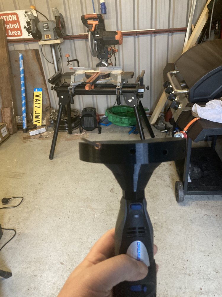

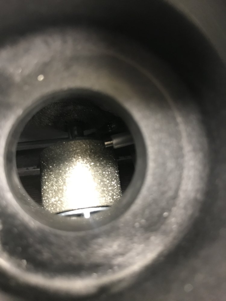

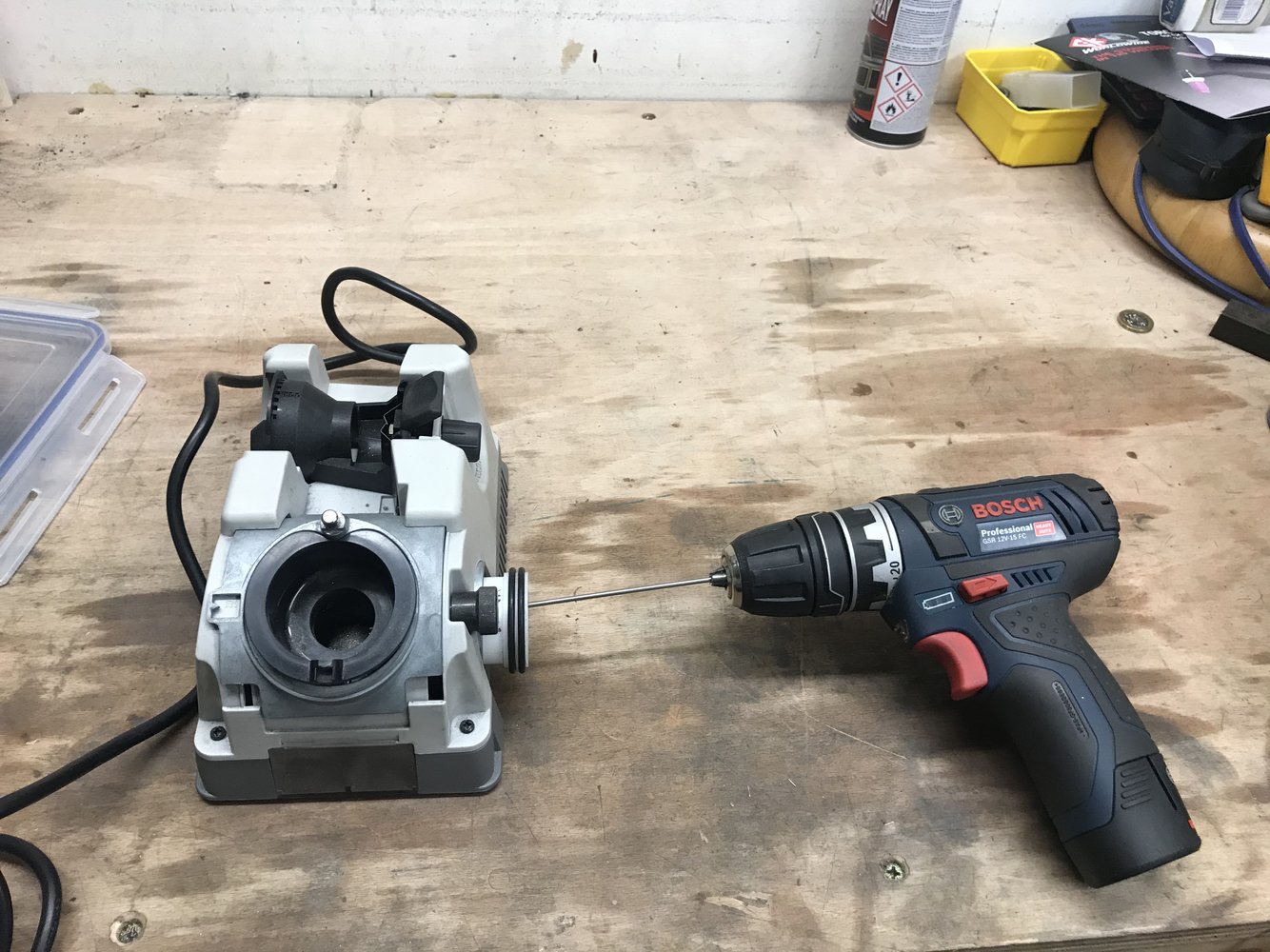

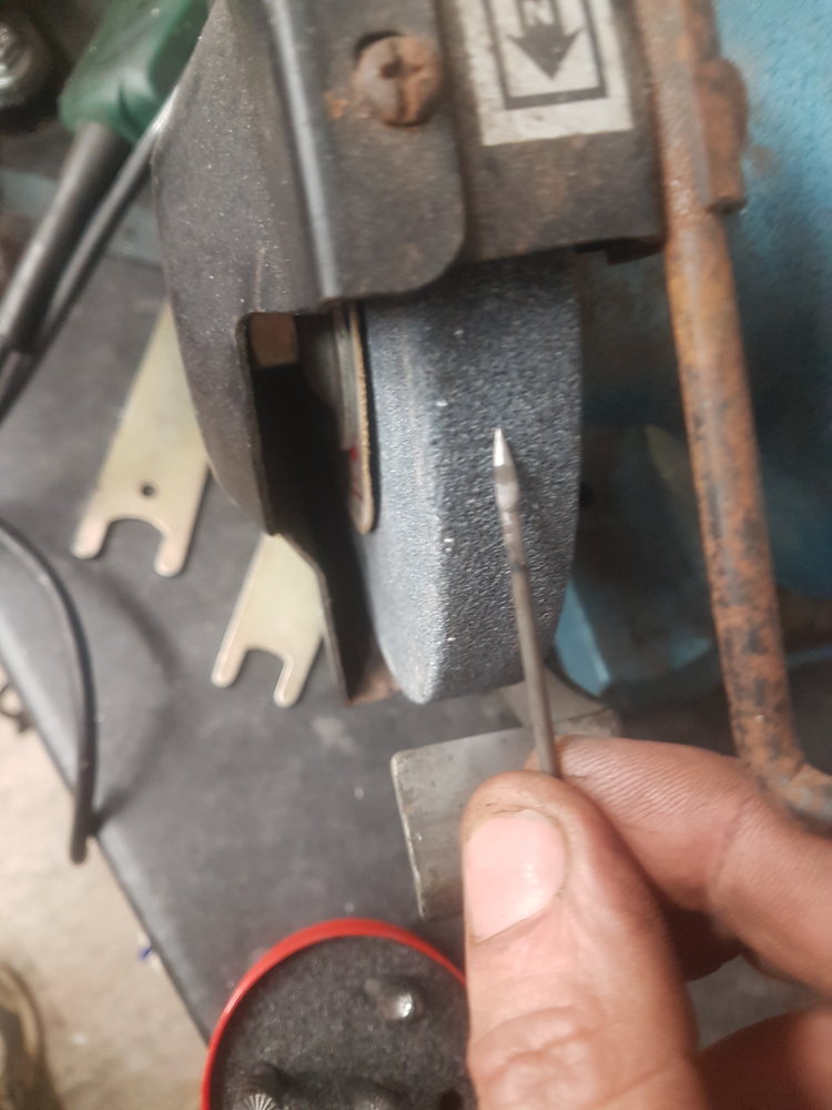

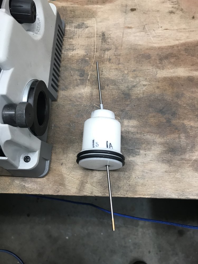

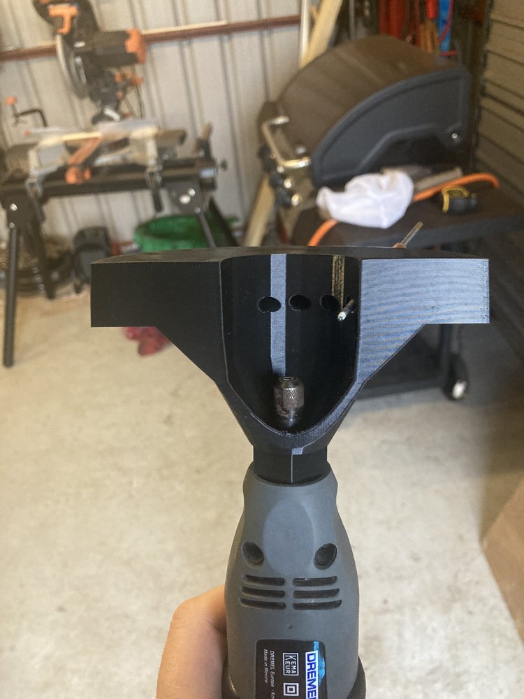

You'd be surprised how efficient it is, to slip a tungsten into a collet holder, finger nip tight, slide into the guide and twizzle until sharpI dont get time for inserting the tungsten into a holder. I have normally dipped it in molten ali and need it quick so I can carry on!
oh no something else i need to makeYou'd be surprised how efficient it is, to slip a tungsten into a collet holder, finger nip tight, slide into the guide and twizzle until sharp
The one at work is really nice to use, and makes sharpening really short tungstens much easier. Ever sharpen tungstens 2" long by hand? I hate it.

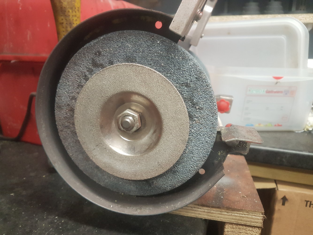

I havecouldnt you bolt a 115mm diamond wheel up against the normal stone wheel?
