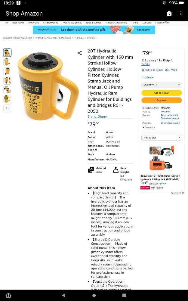

Them hollow rams are brilliant, I have one I use all the time for truck spring eye bushes, downside is when the bush has no hole in it!If you get , the 3rd one, you can take pump of and use it , for other things. Like this hollow ram, for pulling, or pressing.View attachment 490382
