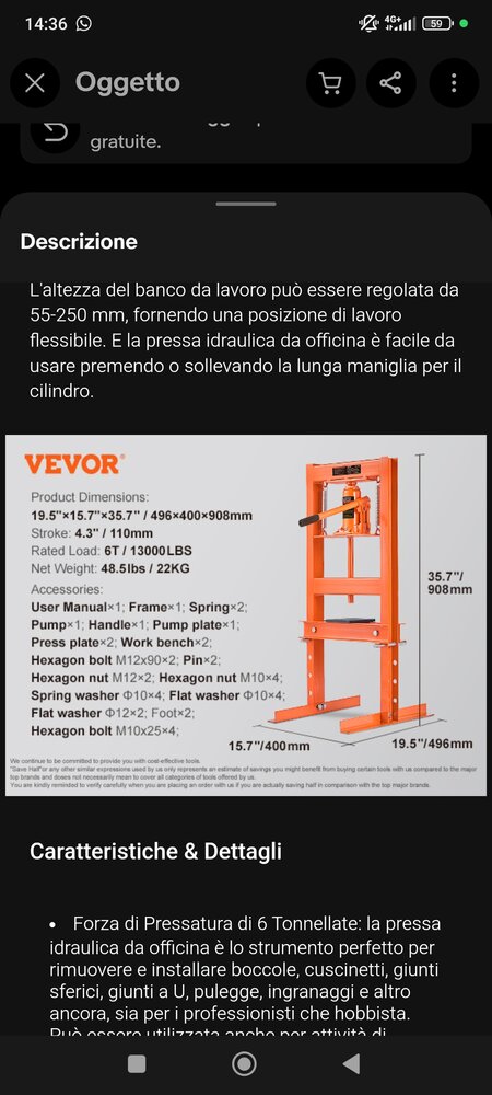

Option #1 the cheaper
6 tons capacity lightweight construction
110mm stroke might be enough might be not.
You can adjust the table up and down about 200mm.
The ram runs through the square tube in the middle Wich might be an advantage because it's kinda like a proper hydraulic ram but it's an additional wearing spot

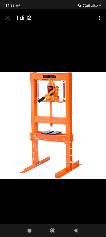

Option 2 the kinda ok for me
Not expensive really but not as cheap as the other one
12 ton capacity, 120mm stroke, the table can be adjusted up to 610mm between ram and table
Useless manometer I really can't understand why they put manometers on hydraulic presses
Still a bottle jack design so it's possible to replace the jack if needed
But it has a very short fixed ram.

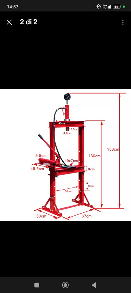

This one has a proper ram and a separate pump 130mm stroke.
Table can be adjusted 750mm up an down in 6 different positions.
The pump has not a fast and slow valve just the release one
