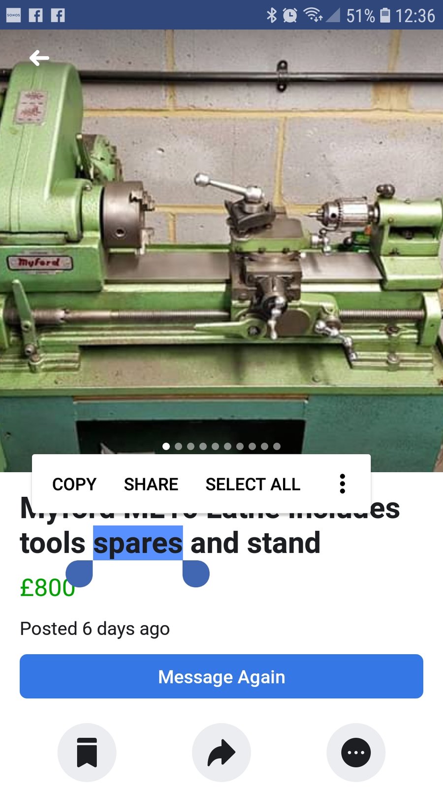

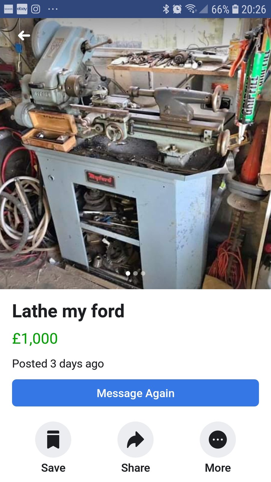

All great advice so what lathe would.you guys recommend that one had sold now. But I don't want to upgrade 5.months down.the roadmI had a "starter lathe", a British Challenger form the 1940s/50s, broken backgear, only a handful of changegears, pretty worn out - but it only cost me £70, came with a far too big 3HP singlephase motor and a bunch of accessories. Worked well enough for making spacers and cutting things down/drilling and boring out, but very limiting!

It wasn't plug and play, as the C13 has a 3-phase ONLY motor (dustbin sized 3-speed with lots of windings, had to hack a VFD to run it off 240, rewire completely in my usual overcomplicated fashion that cost half as much again), but it cost half the price of that first Myford, has a proper QCGB that does imperial and metric, power feeds, taper attachment... Has a nice almost art deco look about it too
