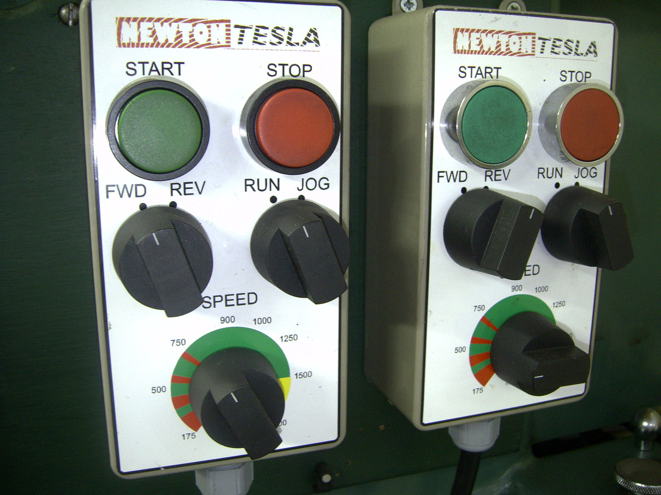

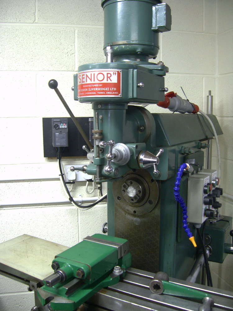

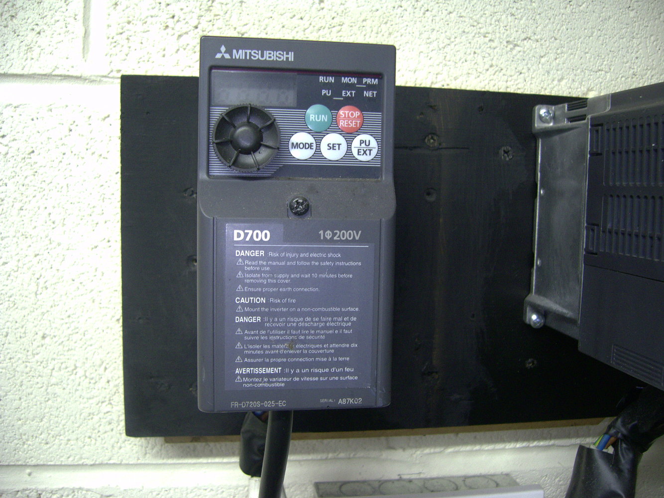

Lovely looking machine @Arc Tourist, is that an original 370 W motor on the vertical head? If so do you find the power adequate?When I purchased my Tom senior mill which was formally from a school, it came with a pair of inverters and speed control units for both horizontal and vertical applications. Hear are several photos.
Edit : Click on the Inverter photo to enlarge for clearer reading of information on it.
View attachment 336633 View attachment 336634 View attachment 336635
Yes, its the original motor. Both inverters on the mill ( which are the same model ) work off of 13 amp receptacles, and power is adequate.Lovely looking machine @Arc Tourist, is that an original 370 W motor on the vertical head? If so do you find the power adequate?
Sorry, my question was meant to be do you find the 370 Watt motor adequate? I believe some folk fit 750 W (1 HP).Yes, its the original motor. Both inverters on the mill ( which are the same model ) work off of 13 amp receptacles.
I'll try again soon.No problem, I downloaded a manual from the Tom Senior Milling Machines page on Facebook,Can't seem to get the www. address for downloading a Tom Senior mill manual to post. It shows up on my favourites list, and I can access it, but comes up that the site doesn't exist when I post the link here ?I'll try again soon.
