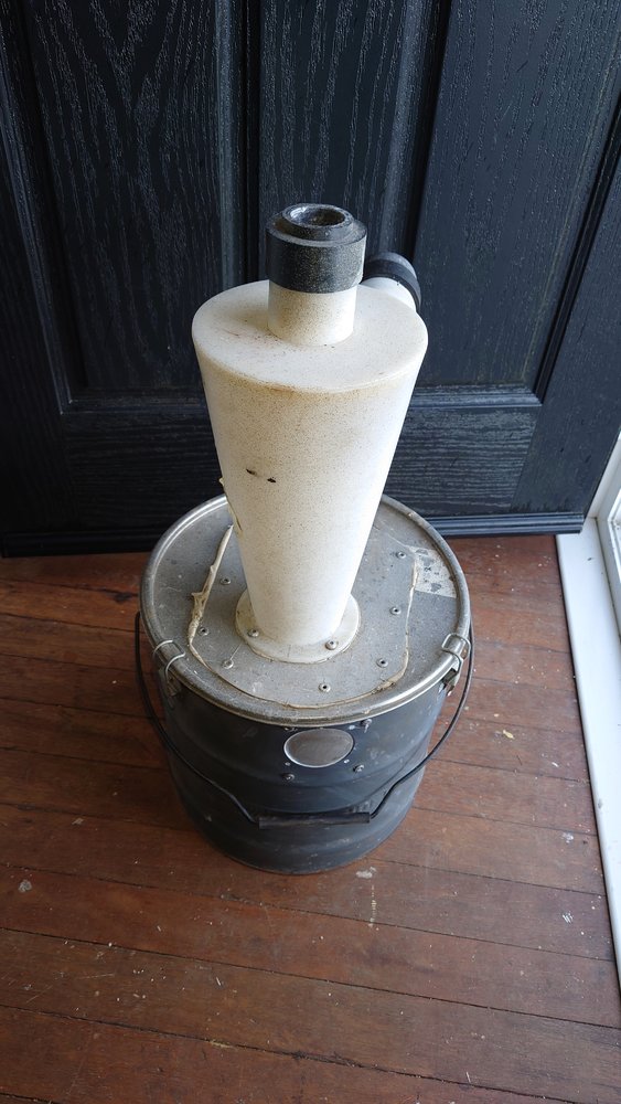

There is no such thing as a vacuum except in some folks heads .I 've used a thick walled ( 1/2 "old heavy black conical plastic dust bin for our sheds cleaner . Made a long radius set of arms for the router and routed out two bIn & a bit sized diameter rounds (78cm. dia ) in 15 mm ply ,got the them glued & screwed up , then put cling film over the rim of the bin and then ran a decent thick bead of silicone round the rim , set the lid on with weights and let it cure for a week before cutting the cyclones holes . Made simple blocks to fit the lid so it always locates over the lock down handles . It appears to work well . The thick wall conical shape is tremendously strong , I didn't need to make a pressure relief flap for the lid in case the depression inside got too great .The cyclone is up and running again.
I had a spare tub from one of the Lidl ash collectors that were so rubbish I don't know why I bought two, but at least I had a spare.

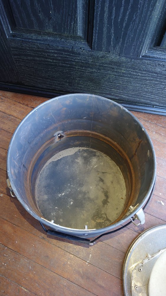

To prevent this one imploding, I rolled a ring out of 25 x 5 flat bar and hammered into the center of the tub.
It's a tight fit so I didn't fix it in place but just welded the ends of the ring together.
I also pop rivetted a plate over the original inlet.
We will see if this is man enough for the job.
