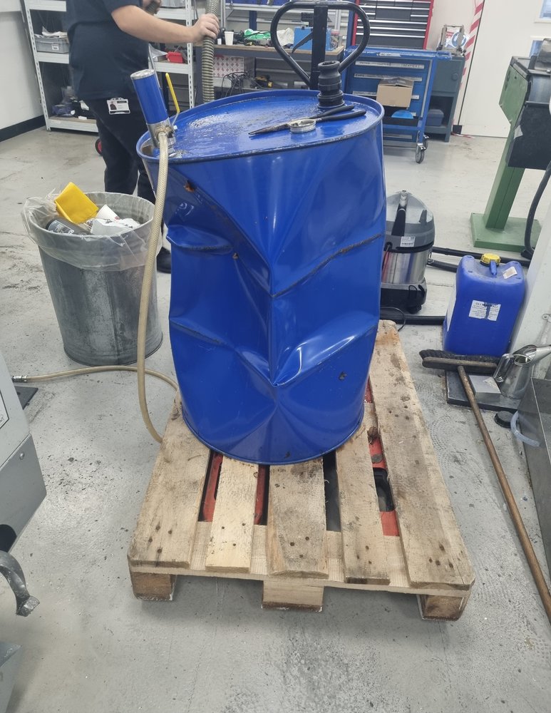

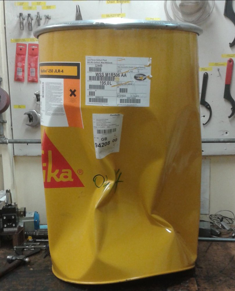

Nope - it's atmospheric pressure you're feeling . . .Ya pedants. Put your hand (nothing else mind) next to the vacuum cleaner hose, that's suction....
Managed to break another toilet seat.
Suction?
Yep, the way our physics teacher explained it: if you put your hand over a pipe and then put a vacuum in the pipe, there's nothing in the pipe. You can't pull against nothing so it's the something on the outside that's pushing, not the nothing on the inside that's pulling.Nope - it's atmospheric pressure you're feeling . . .
If you connect mains pressure water to it, it will blow back out again, safely.

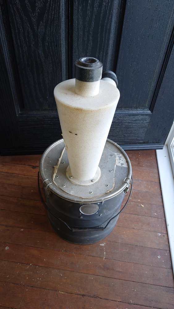

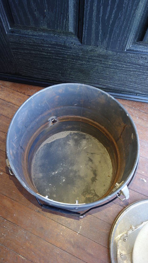

The cyclone is up and running again.
I had a spare tub from one of the Lidl ash collectors that were so rubbish I don't know why I bought two, but at least I had a spare.
To prevent this one imploding, I rolled a ring out of 25 x 5 flat bar and hammered into the center of the tub.
It's a tight fit so I didn't fix it in place but just welded the ends of the ring together.
I also pop rivetted a plate over the original inlet.
We will see if this is man enough for the job.
I must say it is handy having a ring roller for the few times you need it.

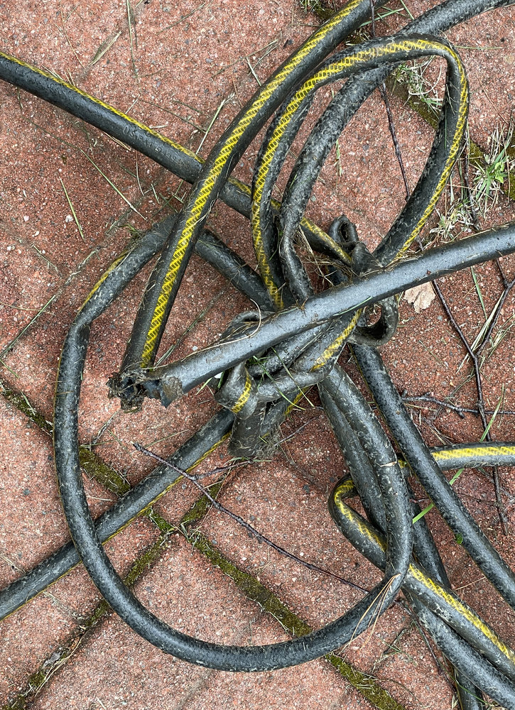

Been there, done that, but easier to remove than barbed wire.Today I introduced our bush hog (rotary cutter) to one of our garden hoses. The meeting did not go well.
