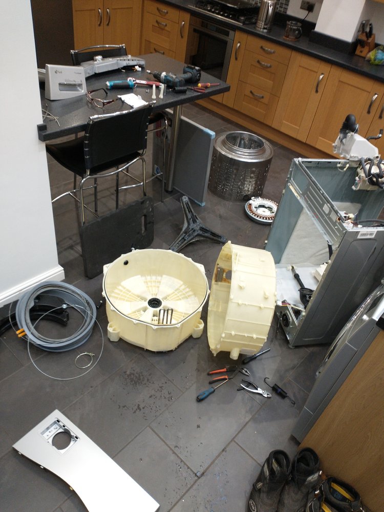

... technically the missus broke it by using it more than me
Nice relaxing Sunday morning....
View attachment 426664View attachment 426665

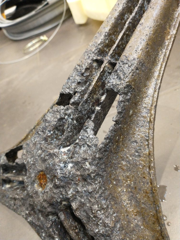

Its been pretty good TBH, so not too bad...its 12 year old. Lucky we live in soft water area? The drum support spider has a crack in one arm, which obviously is under more load when she's doing towels. This has thrown the drum out of concentricity, which has damaged the door seal. The drum has also sustained some minor abrasion, but should be ok.Snap, our Whirlpool lasted 10 years, replacement Beko is 8 years old now.

Might as well change the bearings and drum seal while I'm in there..
