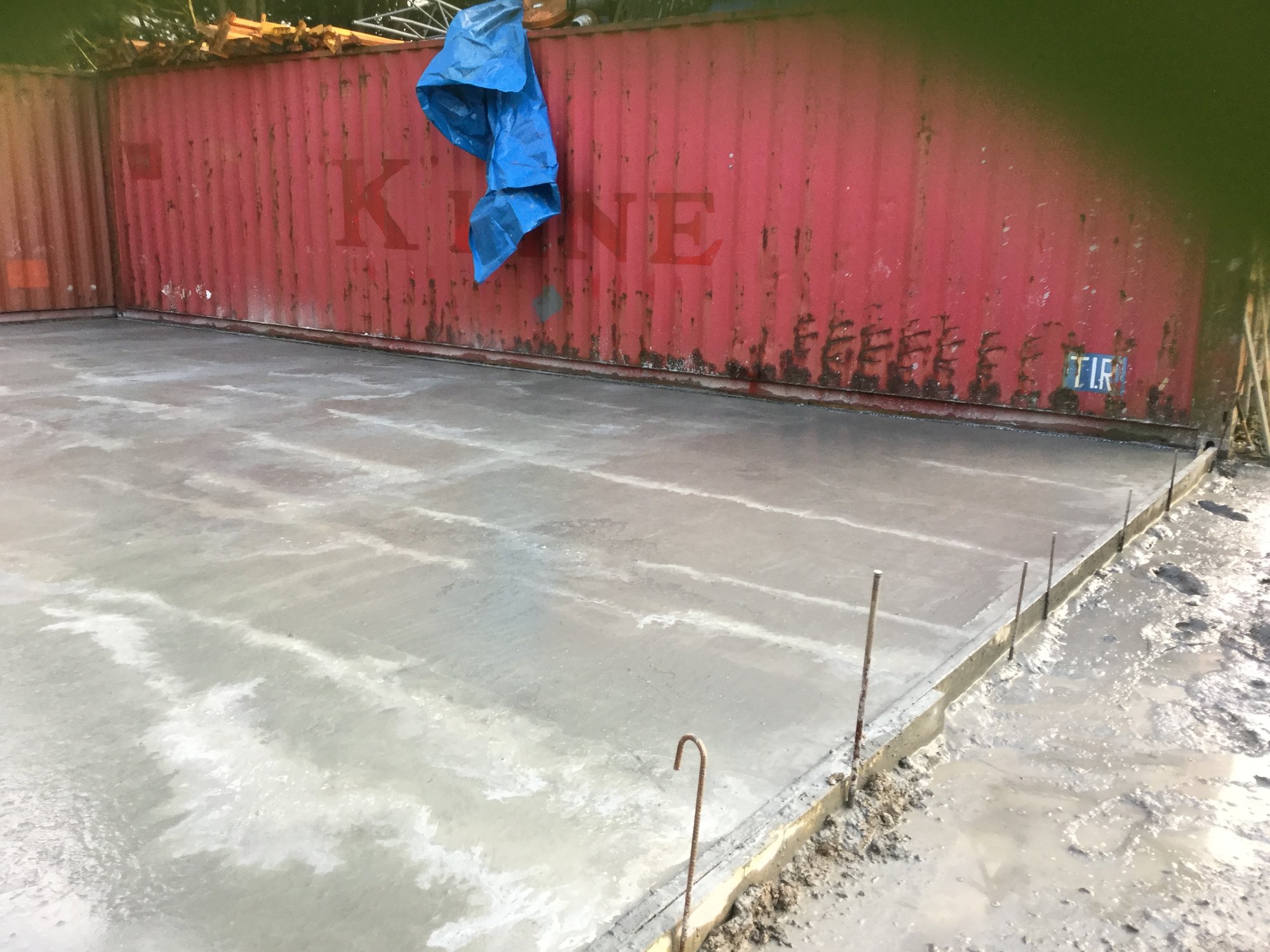

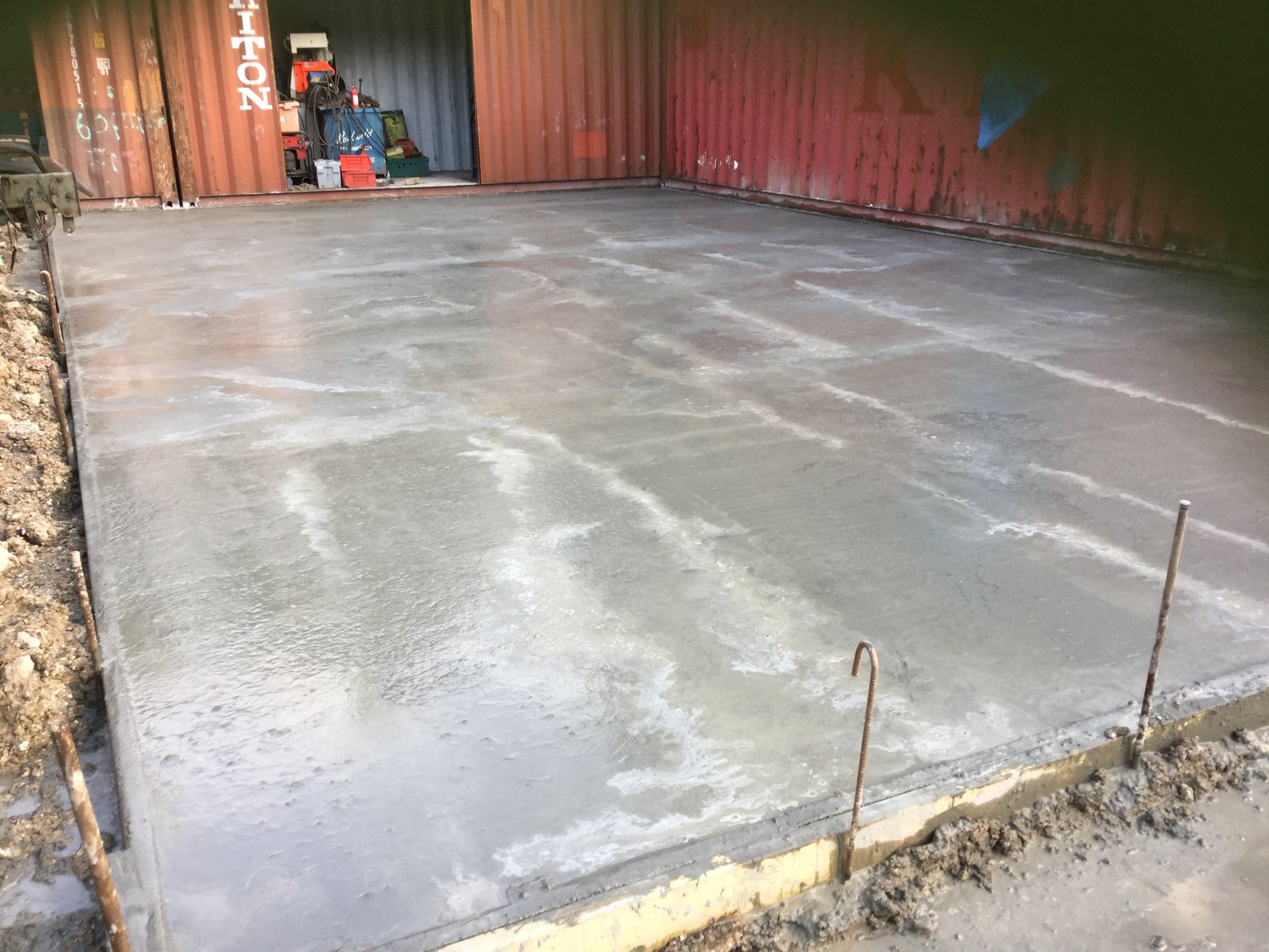

Bob has his own sense of time and space. I think ever since I've known him that Stolly hasn't moved (admittedly only known him a few years). He said he needed to finish concreting the man cave so that he could move crap into there so that it would free up the 101 before he can start on the Stolly. Well the man-cave concreting has just happened after him saying to me it was going to be last summer...????
Any further news to report @8ob ?
) Thats all gone off now so Mick my fabby has been fettling the six post lift and other bits that are going over to that bit of the yard, air and leccy are over there now, may buy one of these container canopies . Should be all functional within a few weeks.

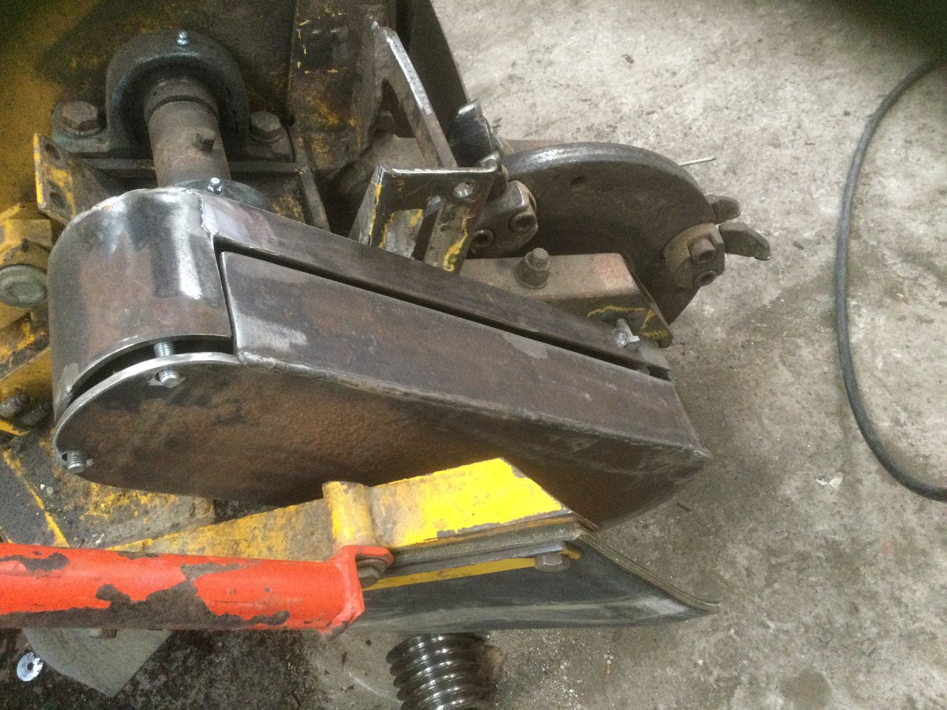

Pulley guard on one of the grinders has been bodged for the last time so I ripped it off and made a new one out of 6mm.
Used a slice of 6" pipe for one end and a slice of 4" for the other.

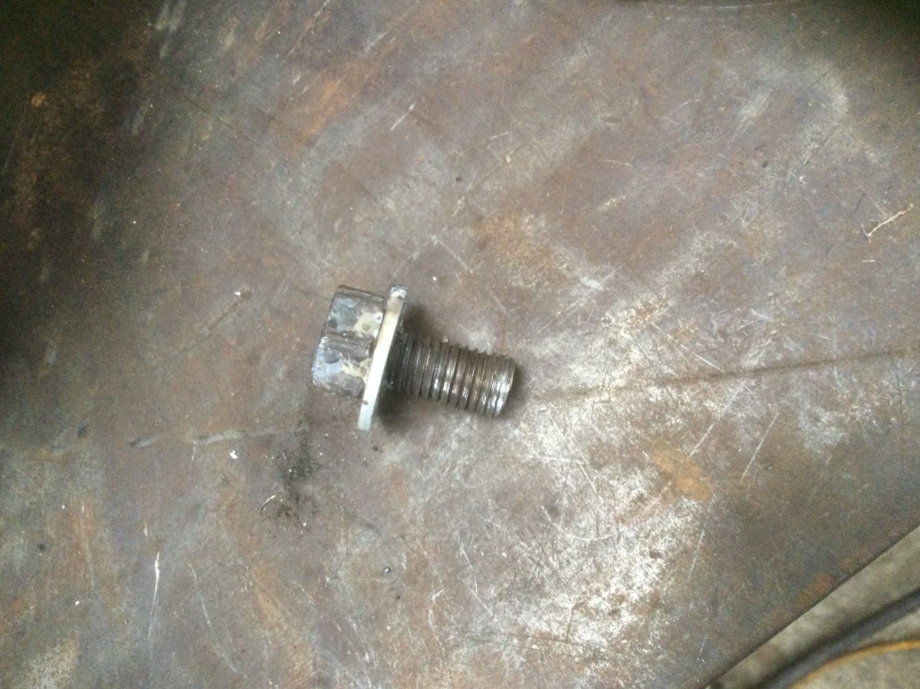

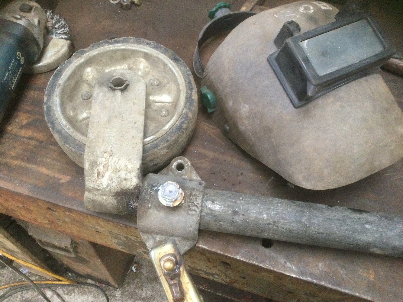

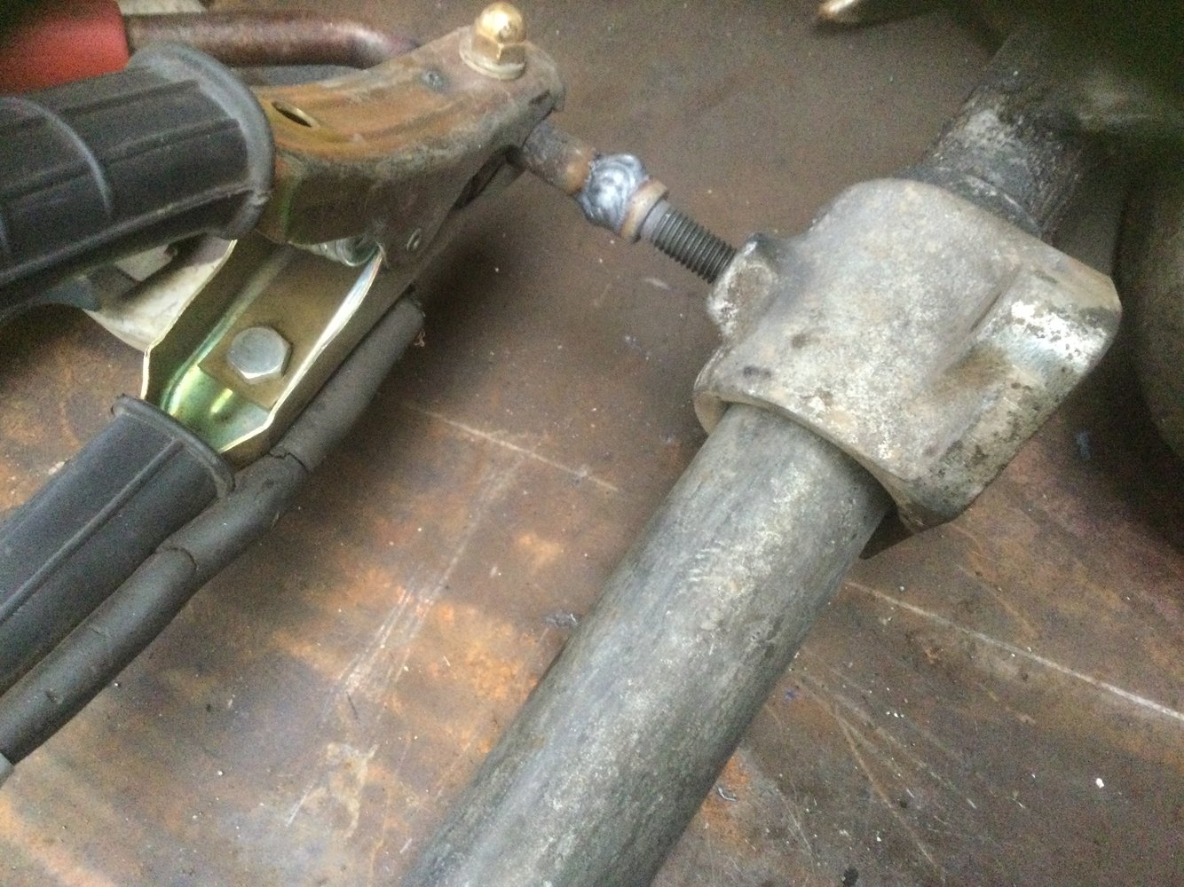

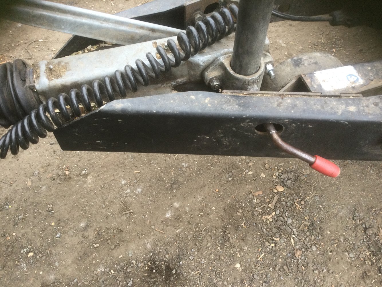

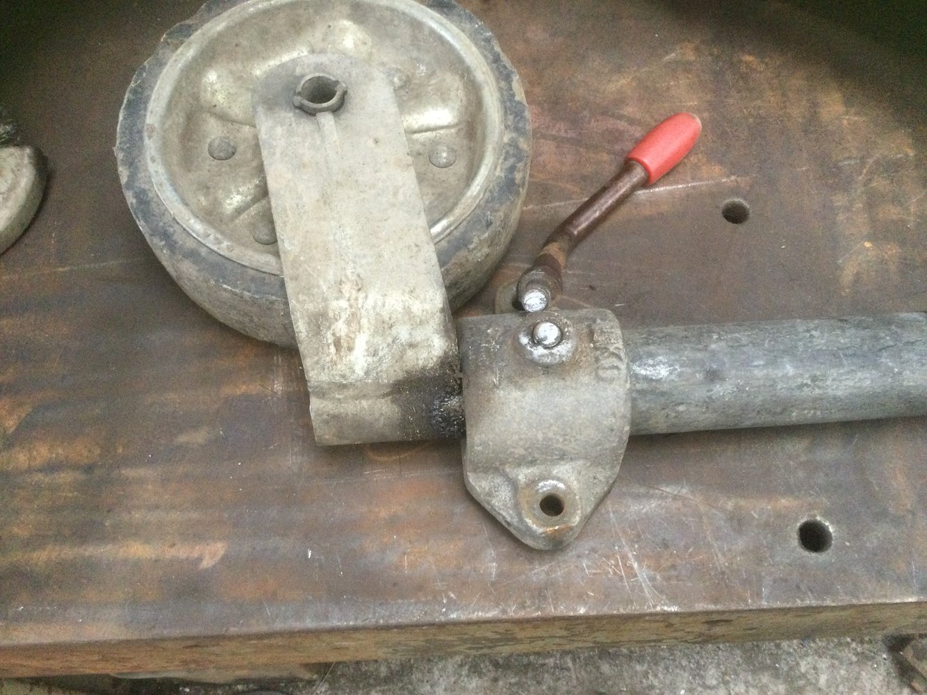

Jockey wheel on one of the chippers had a sheered off pinch bolt ( happens when you kick them tight)
Plug welded a 12mm washer and nut to the old one. View attachment 340365
Put up a bit of a fight because the end was gnarled up but it came out.

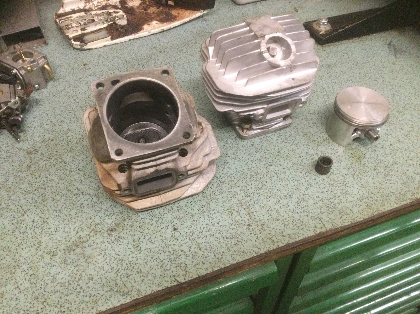

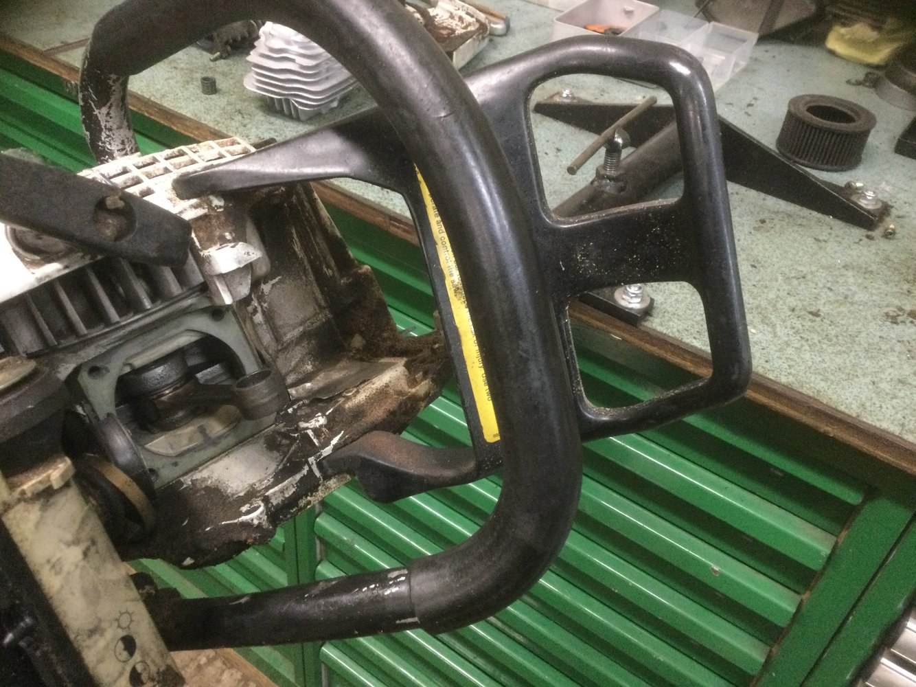

Barrel and piston time for one of the saws. Will put it back together tomorrow .
