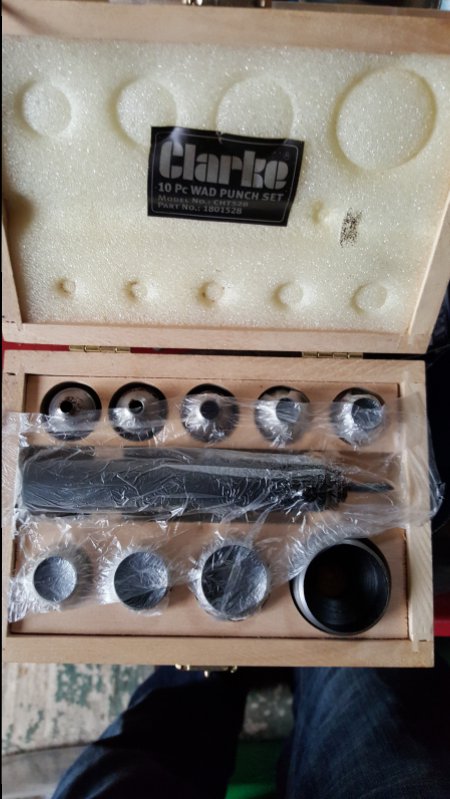

Thats Spencer with his fancy punches. Good job I didn't mention I use my cnc milling machine with a homemade drag knife mounted in the spindle and draw them in cad and let it cut them out for me.What's wrong with empty cornflakes packet!! Bloody posh boys with your gasket card and wad punches![]()

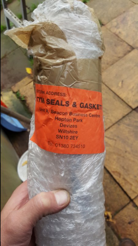

I use Klinger it always seals.Klinger c4430 it's pretty good stuff ! Used through the the oil industry
im not happy using the liquid gasket options, i have used them before for this application but everytime i have to re-visit the area i have to destroy the gasket and then clean teh mating faces etc.

And there you have it....I try and help people by sticking my two pence worth in....and there is always one that has to stick a good 30 quids worth in with there cnc cutting and cad programs....well I hope it develops dyslexia. ....Thats Spencer with his fancy punches. Good job I didn't mention I use my cnc milling machine with a homemade drag knife mounted in the spindle and draw them in cad and let it cut them out for me.

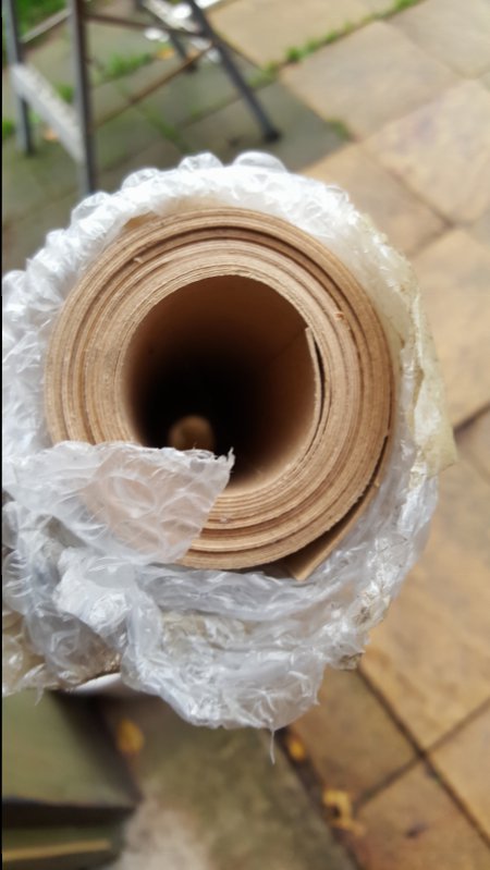

Greaseproof baking paper is a good, thin gasket material. Are you sure you're not bowing the plate when you tighten it down?
Yes .will it hold up to the oil?
I was told that it did two things by the guy who taught me it first, first it let whatever you coated the gasket with (shellac, varnish, thin sparing smear of rtv etc) to make it oil safe penetrate the cardboard to do its job or it starts to ooze slightly a few months later, and secondly when a box is chucked round the supermarket, its the shiny outside that's more likely to incur scratches and be dented slightly so by removing this layer it improves the chances of sucess.I've made loads of cereal gaskets, none have leaked and I've never heard of picking off the glossy side...
I've always assumed (maybe wrongly) that the fluid it's sealing in get's slightly absorbed and causes the fibres to swell a bit, increasing the seal.
