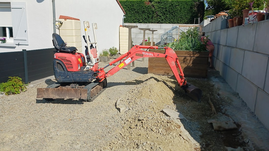

I'm pretty damn sure you'd get a micro digger in there. Worst case is just scrape it all back towards the doorway as you go, yeah it'll be a bit tight operating it but a damn sight easier than by hand...
*** PRE-ORDER *** Buffalo B600 Mini Excavator - ETA 5th January
Explore the versatile B600 Mini Excavator, Mini Digger, and Micro Digger by Buffalo Machines. Designed for efficiency and power, these compact machines offer unmatched performance for your excavation needs.buffalomachines.co.uk
The only issue I see is in loading stuff into a micro dumper but you shouldn't have an issue loosening stuff off and pulling it back.That's what I was wondering - if you couldn't utilize the depth gained as you went along.
I just don't know how the arms work and if it's possible to dig the depth as you work like that.
On the machine I linked above the main boom doesn't look like it'll lift high enough to hit anything so then all you'd need is a bit of half-pipe cut and cable tied or something to the cylinder rod to restrict how far the dipper ram can retract to prevent the bucket going up too high.Is it possible to put a restrictor on the ram of a machine so that it is prevented from accidently booming up through the ceiling?
