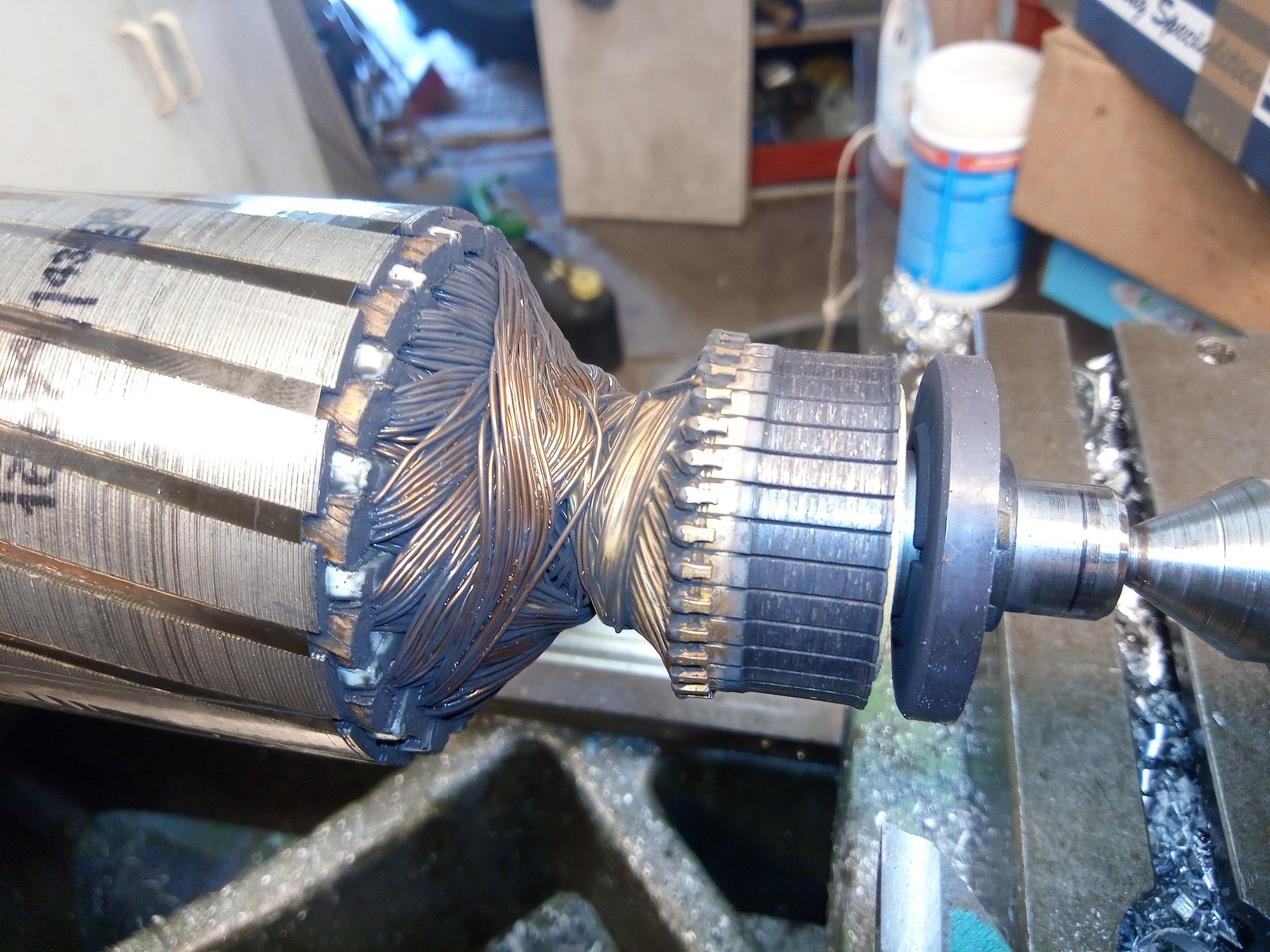

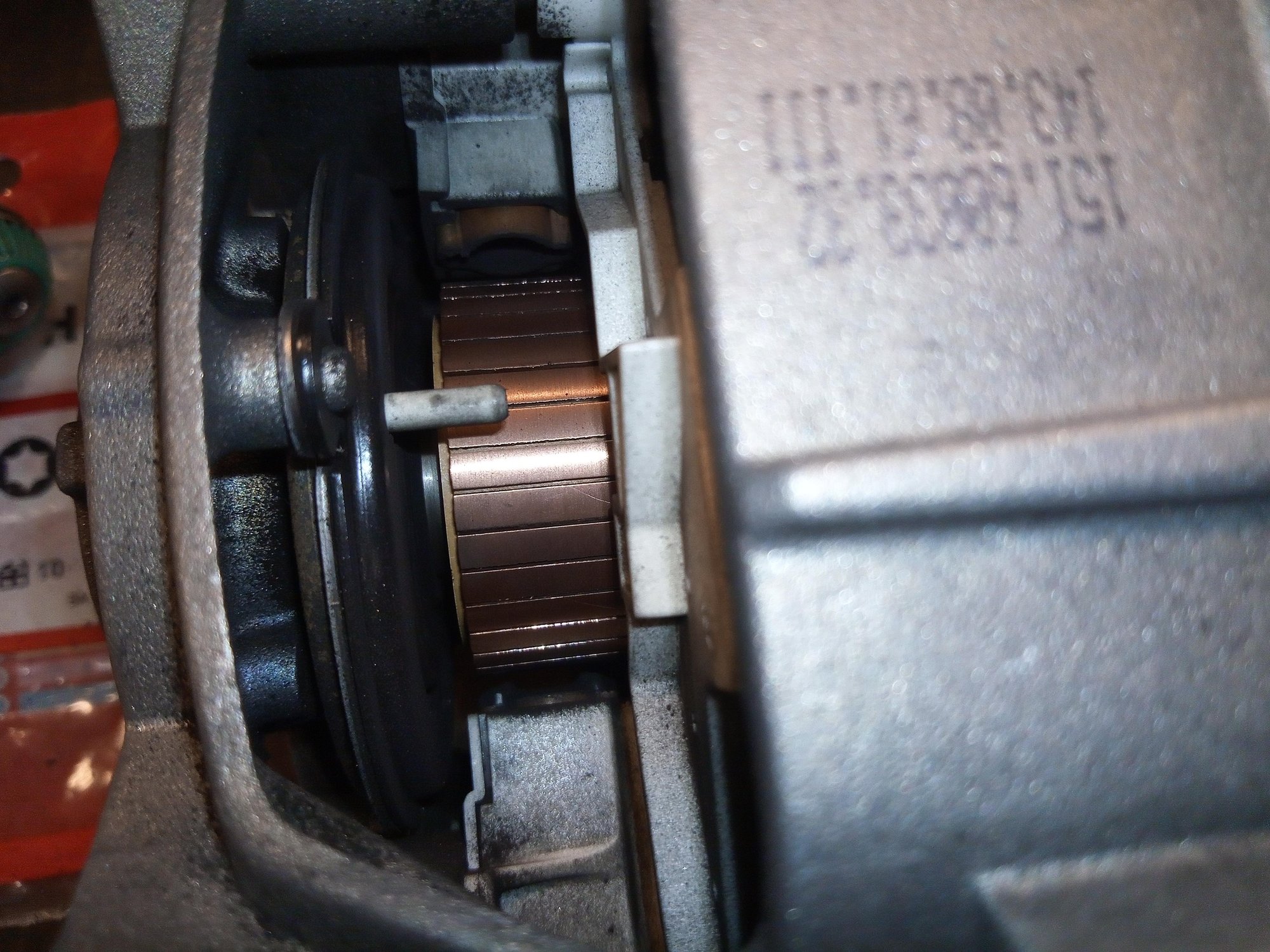

Washing machine errorcode f43; brushes.View attachment 242949
To this:
After this I collected the brushes, hope they last few more years since they cost 45 €! (original Siemens)

Runout must have been ok I think?
Bearings seem ok and I didn't shape the brushes.
Stuck brush seems most likely.

^Exactly.4 years is not bad if it's used daily.
