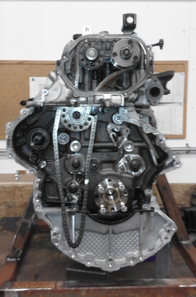

It seems that Jaguar didn't learn from BMW's mistakes.
This is a bang up to date Ingenium diesel from a 4 year old Jaguar XE, and yes, timing chain/tensioners worn to the extent that it has jumped a couple of teeth. And it's an interference engine so game over and not uncommon unfortunately.
