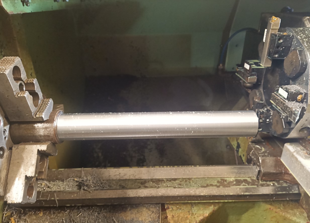

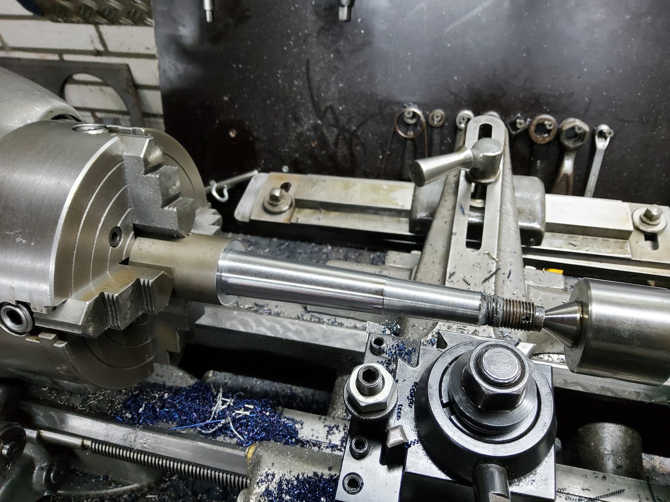

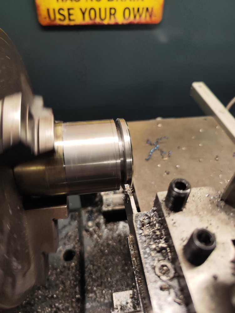

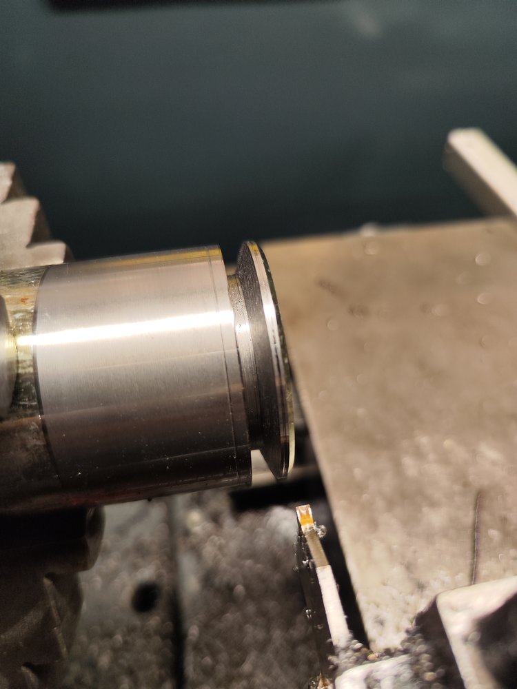

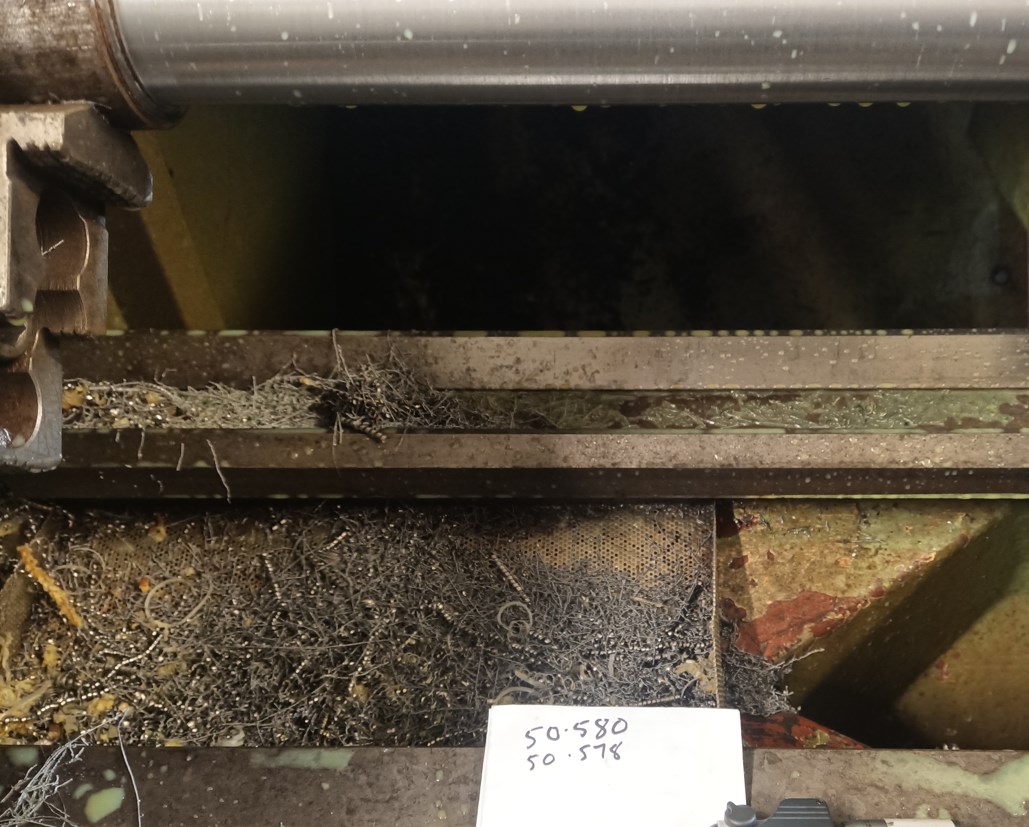

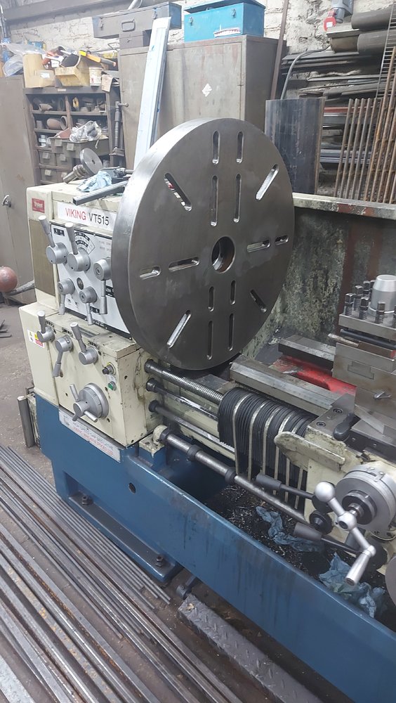

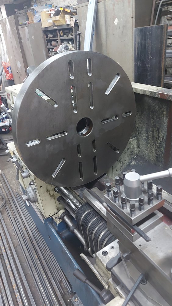

I noticed the last week that the lathe was cutting out a bit, the whole building moves over time due to the action of the waves as my workshop lies between the sea wall and a burn and the water seeps through the sea wall into the burn and takes soil with it leaving voids under my workshop.
So today I chucked up a length of round bar and started doing some test cuts and adjusting the feet to compensate, saves having to do a semi finish cut to measure then programme a cut to remove any taper.
Cut length was just shy of 400mm
This was the measurements after adjusting, I can live with 0.002mm difference over 400mm. Sad thing is the next storm it will be out again
