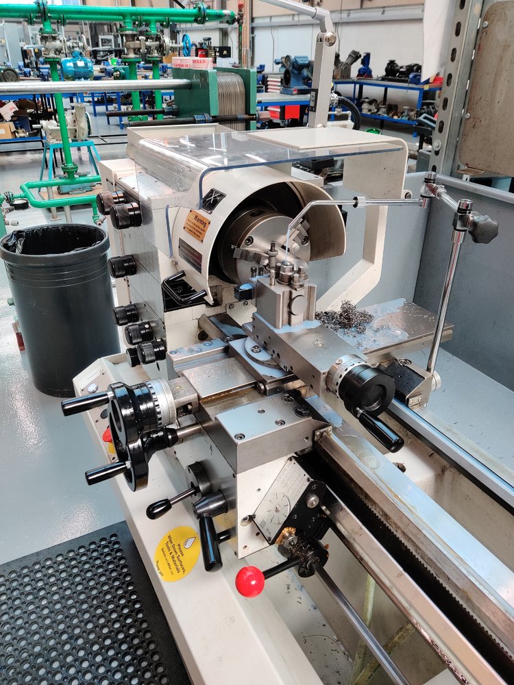

Ha ha I am not worried, just trying to get a handle on the relative size of the two lathes. The Mastiff looks a bigger lathe but in reality it is not that much bigger just the Computurn is like me, dumpyDon't feel beaten @Hood .

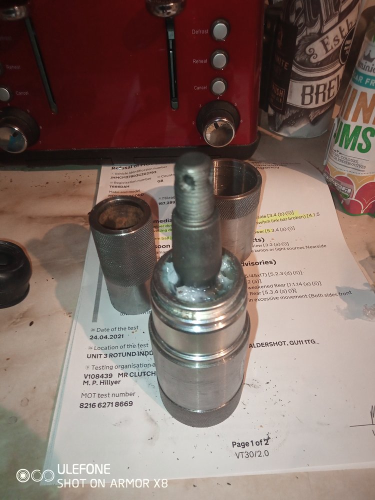

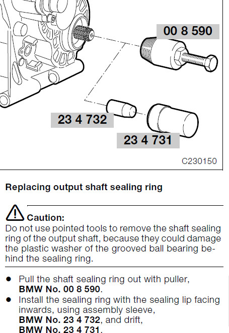

Nice job for a 3D printed part.Nothing I guess, though I don't know if the access would allow it. I just found a picture of the BMW tool and made something similar.

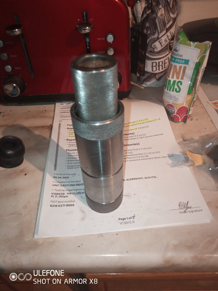

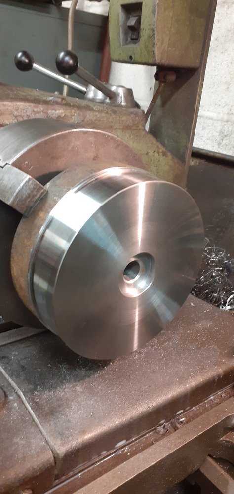

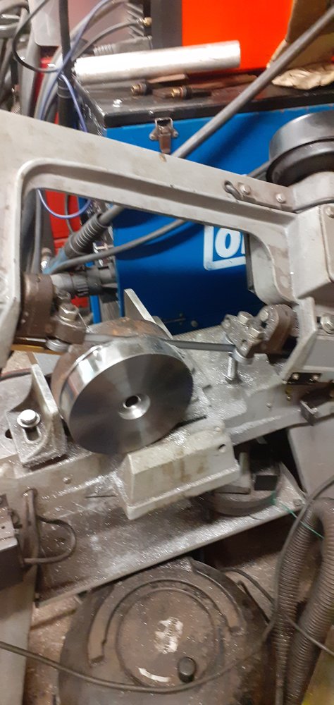

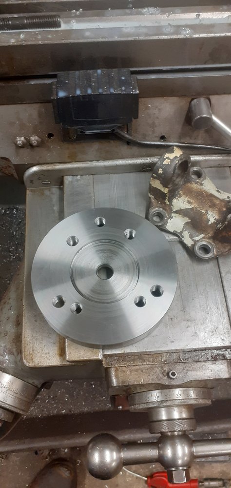

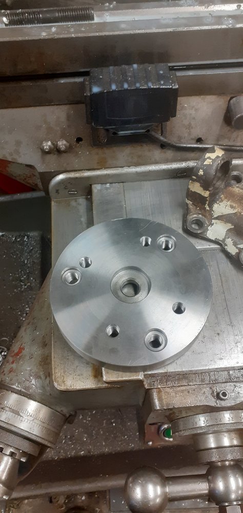

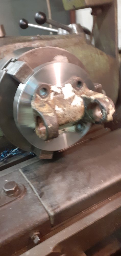

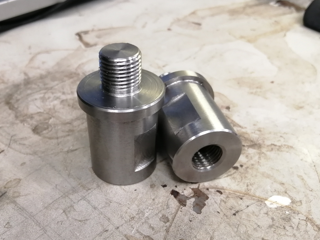

Made a propshaft adapter out of 150mm en19t for a mates overlander.

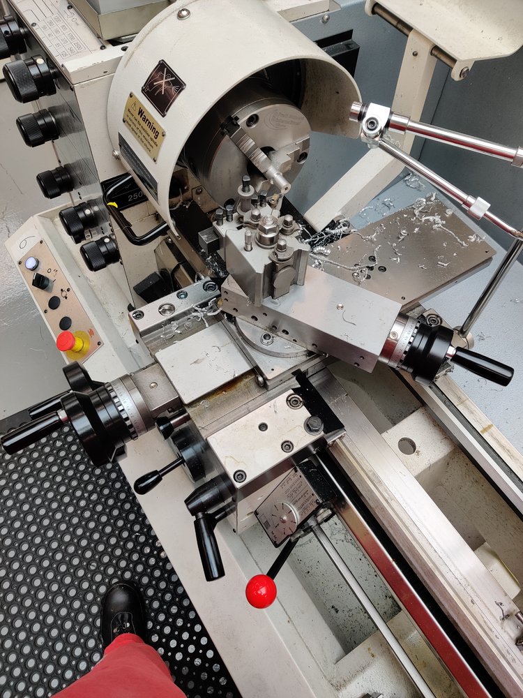

Not mine unfortunatelyThats an unusually clean lathewhat is it?

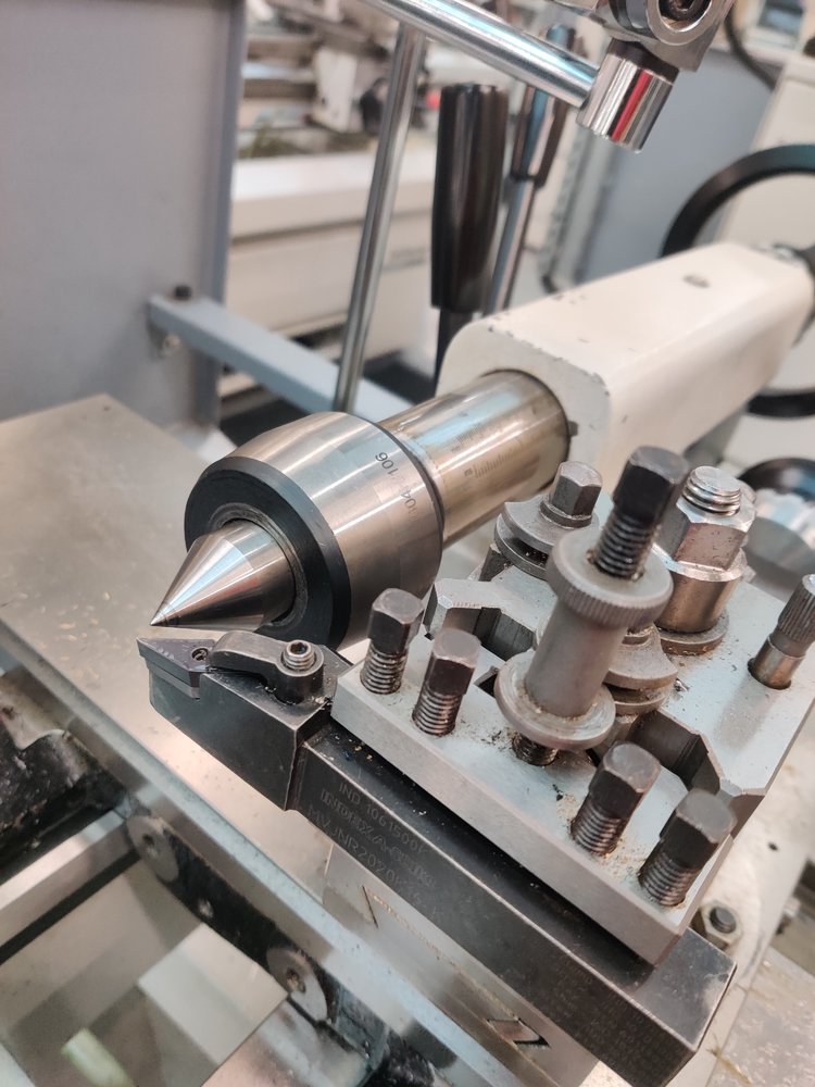

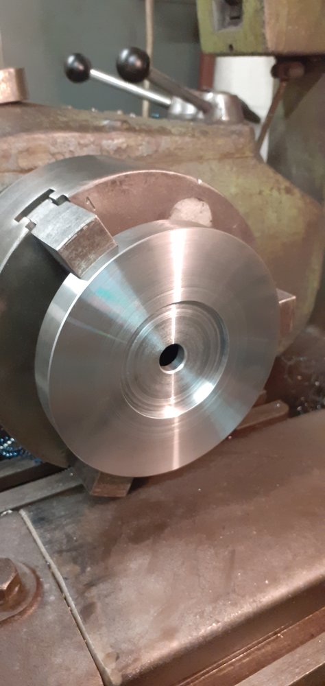

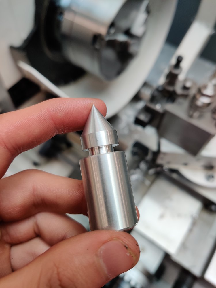

Very nice. What rpm and can you take a close up of the tool tip please?First time cutting a taper quite happy with this 30° cut
ThanksVery nice. What rpm and can you take a close up of the tool tip please?
No that's great thanks.Thanks
1700rpm and what I would to refer to as a finishing tip I'll get a pic of the box next time for the exact number , very nice to use and easy to get a good finish in my experience if I'm at a higher rpm and decent feed rate.
This is the tool here as I said not certain on exact tip but will find out
I also use these pointy tools for light cuts and finishing. They give a much better finish especially on my old Triumph lathe which only goes to 1000rpm.
